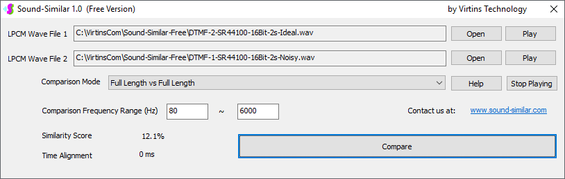

      The former is 2-second DTMF tone "2" consisting of 697Hz and 1336Hz, sampled at 44.1kHz and 16 bits. The latter is 2-second DTMF tone "1" consisting of 697Hz and 1209Hz with the same sampling parameters. The former was generated digitally by the signal generator of Multi-Instrument and thus is ideal without noises. The latter was recorded by a microphone from the sound output by a speaker and thus contains background noises. The volume difference is about 8 dB. The following picture shows the comparison of their waveforms, spectra and spectrograms. The measured similarity score is 12.1% and thus the answer is NEGATIVE (i.e. not FALSE POSITIVE). It should be noted that DTMF tones are quite similar to one another when perceived by humans. If two different DTMF tones have one frequency component in common, their similarity score can go up to a few tens of percent. However, if the two DTMF tones have two frequency components in common (i.e. same DTMF tones), then their similarity score will be very close to 100%.

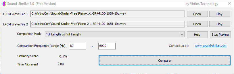

      i. Piano-1-1-SR44100-16Bit-10s.wav vs Piano-2-1-SR44100-16Bit-10s.wav: similarity score 0.5%

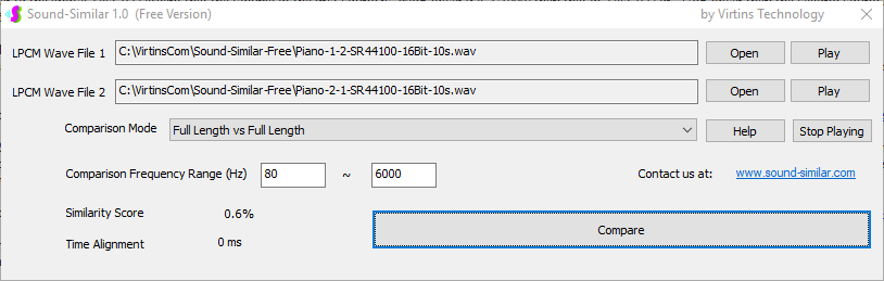

      iii. Piano-1-2-SR44100-16Bit-10s.wav vs Piano-2-1-SR44100-16Bit-10s.wav: similarity score 0.6%

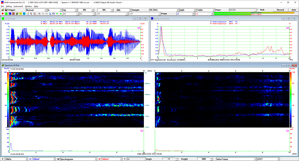

      Both were recorded from the same speech clip ("Because these two really sounds similar!") but with different speaker and microphone pairs and different background noise levels and echoes. The measured similarity score is 80.5%.

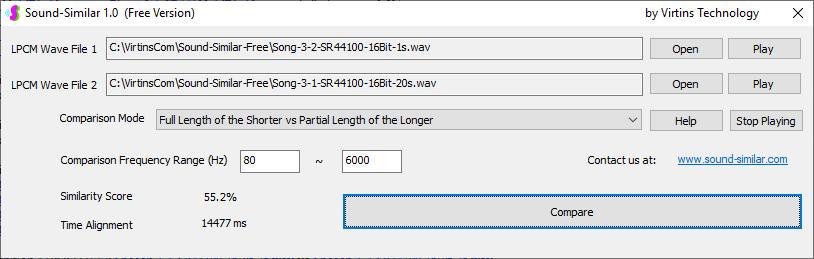

      The two files were recorded with different speaker and microphone pair and different background noises and echoes. The former contains a 1-second excerpt of a song while the latter contains a 20-second excerpt of the same song. The comparison mode is set to "Full Length of the Shorter vs Partial Length of the Longer". The result shows that the sound from 14.477 s to 15.477 s in the second file is similar to the entire sound in the first file with a similarity score of 55.2%.
