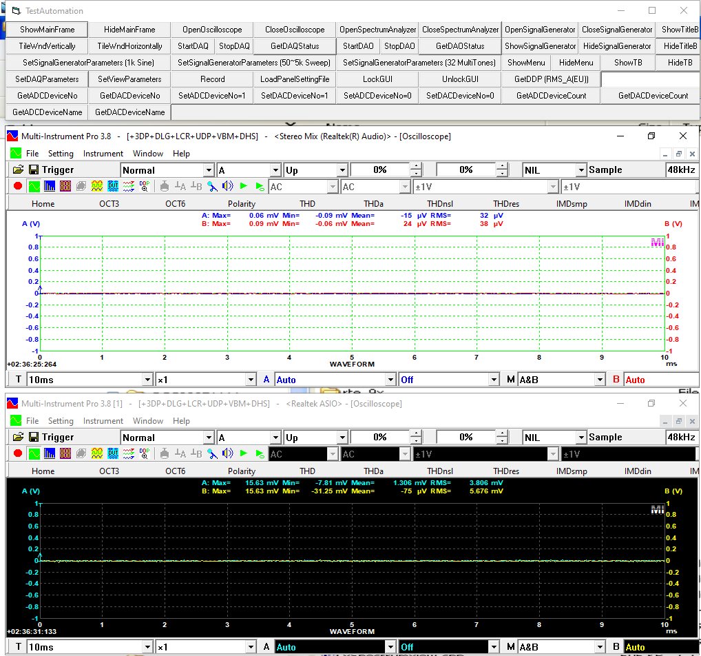

ActiveX automation client sample codes can be found in MI's AutomationAPIs folder. Those sample codes will launch only one MI instance. The following shows the modified Visual Basic codes for the launching of two MI instances.
Dim TestMI As Object
Dim TestMI2 As Object
Private Sub Form_Load()
Dim y As Long
y = (ShowMainFrame.Top + ShowMainFrame.Height) / Screen.TwipsPerPixelY * 6 + 32
Set TestMI = CreateObject("MI.Automation")
Call TestMI.Unlock(63066, 31882, 55598, 6380)
Set TestMI2 = CreateObject("MI.Automation")
Call TestMI2.Unlock(63066, 31882, 55598, 6380)
Call TestAutomation.Move(0, 0, 1024 * Screen.TwipsPerPixelX, y * Screen.TwipsPerPixelY)
End Sub
Private Sub ShowMainFrame_Click()
Dim y As Long
Call TestMI.MoveWindow(WND_MAINFRAME, 0, y, 1023, 600 - 30 - y, 1)
Call TestMI.ShowWindow(WND_MAINFRAME, SW_SHOW)
Call TestMI2.MoveWindow(WND_MAINFRAME, 0, 600 - 30, 1023, 600 - 30 - y, 1)
Call TestMI2.ShowWindow(WND_MAINFRAME, SW_SHOW)
End Sub
The resulting screenshot is as follows:

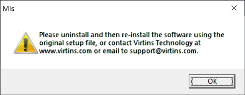

First, about the manual start:
I realized that I always tried to start a second instance by clicking on the taskbar MI Icon.
Then I always get the following message: But when I use the desktop Icon, all works well.
Strange...

This error message "Please uninstall and then re-install the software using the original setup file, or contact Virtins Technology at...." will pop up if the configuration file scins.cfg is somehow incompatible with the current MI version. If it pops up for the second instance only, then an incompatible configuration file scins1.cfg exists somewhere. Deleting that file will allow the software to create a new and compatible scins1.cfg automatically after launching the second instance.
