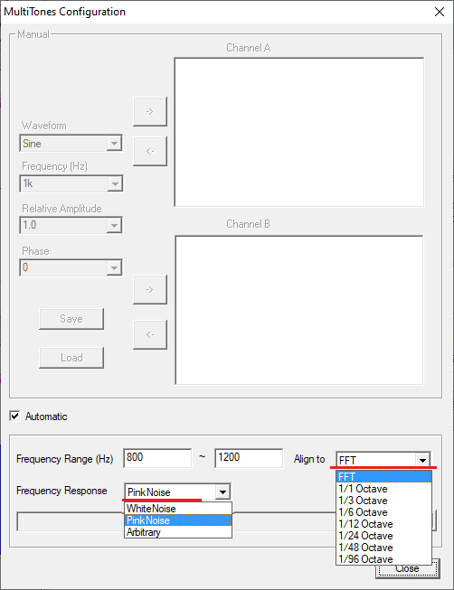

A band limited “periodic” pink noise can be generated using the Multi-tone function of the Signal Generator in Multi-Instrument, as shown as follows. (Align To = FFT, Frequency Response = Pink Noise, Frequency Range is user defined)

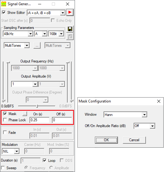

If you want to use the above signal as the carrier frequency and modulate it with a low-frequency sinewave, you can use the Mask (Gated Window) function of the Signal Generator. For example, if the modulating frequency is 4Hz, then set the Mask On duration to 0.25 s and the Mask Off duration to 0 s. For amplitude modulation, Hann Window should be used. For intensity modulation, Cosine 1.0 Window should be used.
