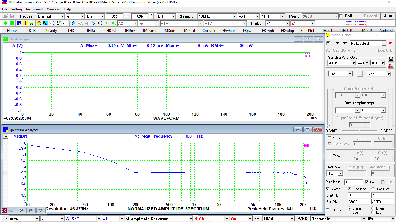

I've done same sweep using built in generator to simplify things :
Screenshot (465).png (88.54 KiB) Viewed 6009 times
question is how do I improve accuracy as zoomed in curve looks like below with a step every bin width:

Postby VirtinsTech » Sun May 25, 2025 8:00 am
1. Generally, with the Peak-Hold method, the slower the frequency sweep, the smoother the measured frequency response. You can also smooth the curve by right-clicking the Spectrum Analyzer window and selecting [Spectrum Analyzer Processing] > "Smoothing via Moving Average". Please refer to Section 3.3.2.8.1.4 of the software manual for details.
Alternatively, you can use the preconfigured panel setting "FRswlog" to perform the frequency response test. This method uses a logarithmic sweep combined with 1/96-octave analysis, resulting in a generally smoother frequency response. You may need to adjust the trigger level so that the Oscilloscope captures the entire sweep from start to end in one frame.
2. After the frequency response is obtained in the Spectrum Analyzer, right-click on it and select [Spectrum Analyzer Generate Frequency Compensation File (Flat)] to create a frequency compensation file. This file compensates for the sound card's unflatness, allowing it to be used for measuring the frequency response of other devices. To load the frequency compensation file, right click the Spectrum Analyzer and select [Spectrum Analyzer Processing]>"Compensation1" or "Compensation 2".

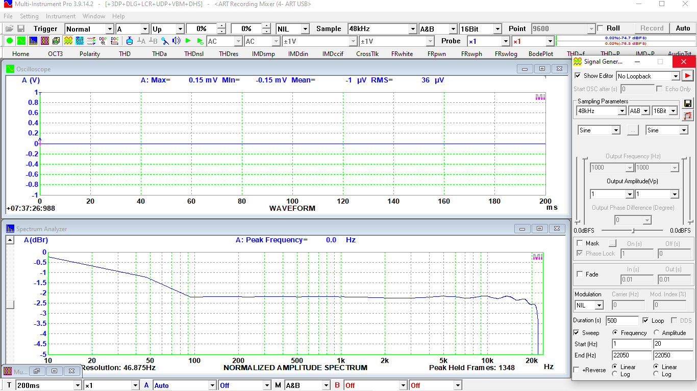

Postby Pete » Sat Jun 14, 2025 2:47 pm
It seems I'm getting nowhere with this
This is a loopback FRswph of my soundcard with standard settings and applied Smoothing via Moving Average 5 points linear, soundcard should be +/-0.25dB within 20-20kHz range

This one is with a longer sweep 500sec
Screenshot (480).png (79.81 KiB) Viewed 2514 times
Could someone explain to me what am I doing wrong?

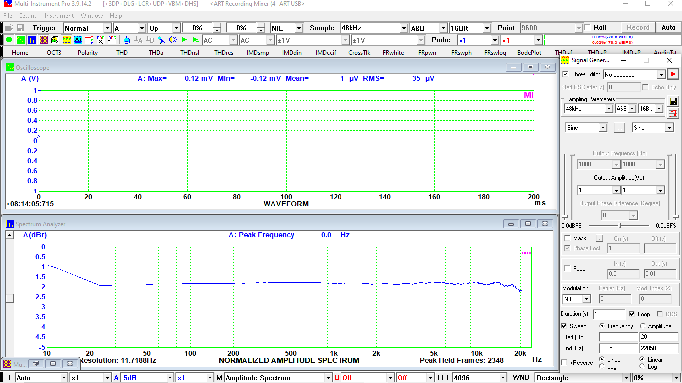

Postby Pete » Sat Jun 14, 2025 3:18 pm
Increasing resolution to 4096 and increasing sweep time to 1000sec with same Moving Average 5 points gives me this , looks better but still looks not exactly right
