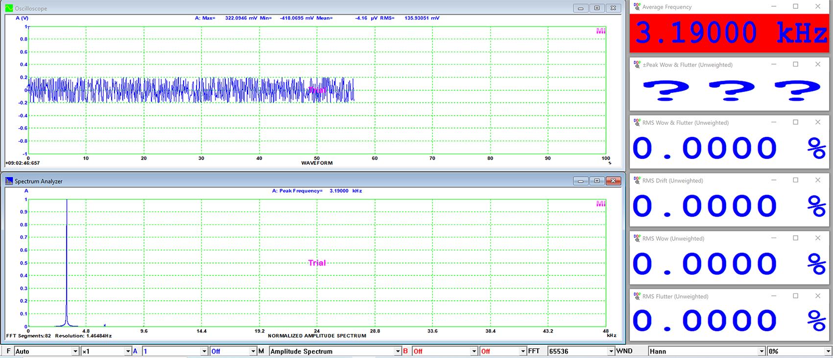

Re: Measuring Wow & Flutter of existing 3150Hz recordings
Your method 2 (Real Time Measurements) works fine
Method one gives me this as per the attached file

In the current version, the Wow and Flutter measurement will not be performed if the Record Length in the Oscilloscope exceeds 2097152 samples (about 43.69 seconds if sampling rate is 48kHz). You can use [File]>[Extract] to save a shorter copy of your recording and then use [File]>[Open] to open that copy to analyze.
