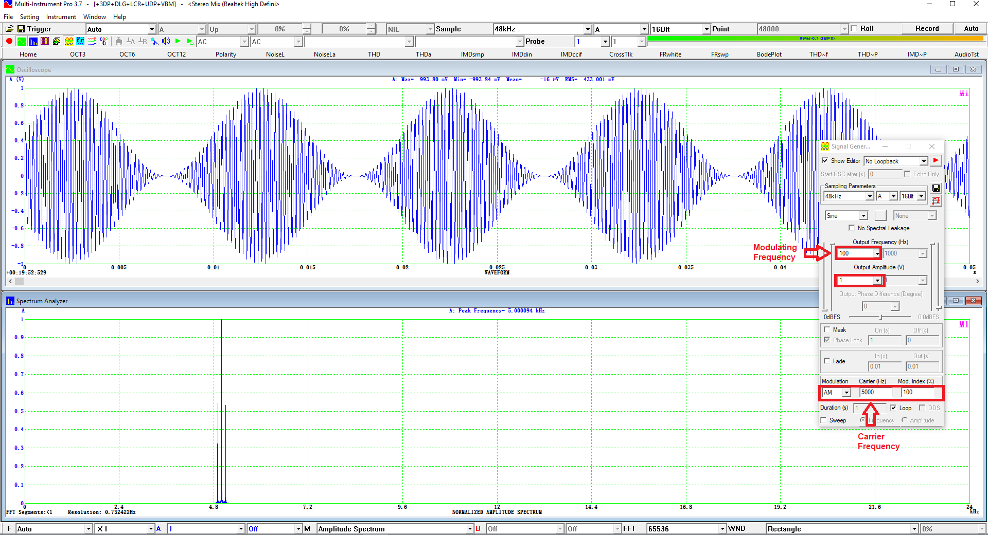

Hi guys.
how can i generate the AM waveform with carrier frequency Fc=5Khz ?
Thank for your helping.
Posts: 306
Re: Signal Generator
Please refer to the screenshot attached
