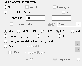

Hello! Saving panel settings with parameter CCIF3 causes the program to crash when opening this setting. I'm using version 3.9.7.3 with a sound card ADI-2 PRO fsr. I am attaching the settings file.

Thanks! This might happen if the selection is switched from DIM to CCIF3. It has been fixed in the new version 3.9.8.0.
