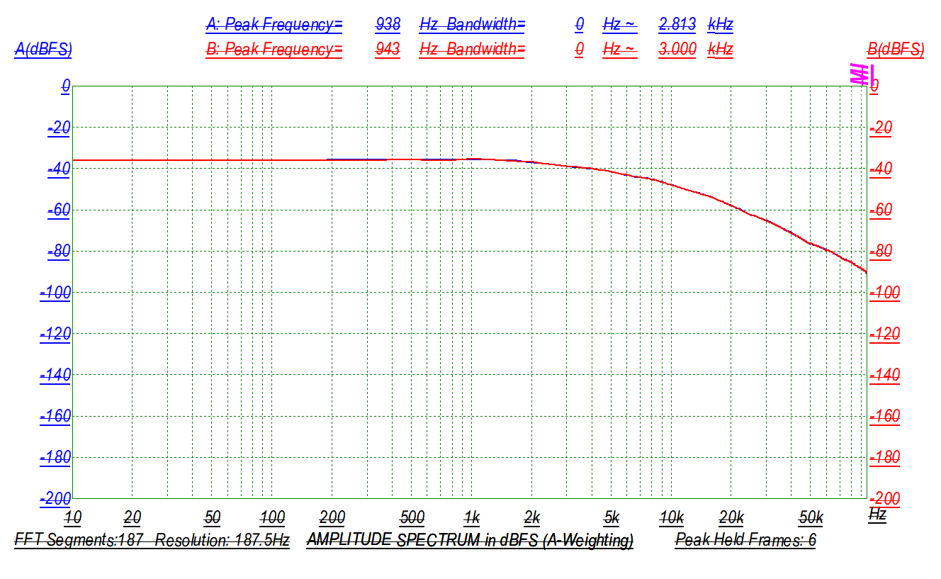

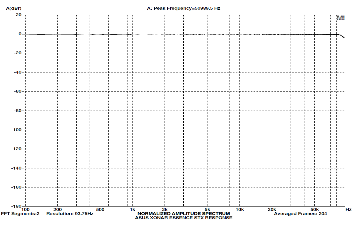

When I changed the MB and the OS to Win7 x64 Pro I lost the good performance, currently on spectrum analyzer bandwidth measurement. Please see the previous bandwidth on the lower pic and the new on the upper pic:
Both measurements are in Loopback mode, with 192K-24bit white noise. I tried any combination with the signal generator and the spectrum analyzer processing without any improvement. The bandwidth always falls at 3Khz on both channels.

Thank you for your questions. The two were measured with different method despite the same white noise excitation was used. "Asus band.png" used inter-frame linear average and no frequency weighting while "adc1.png" used inter-frame peak hold and A-Weighting. The setting of the former one is correct. However, it still cannot not explain why the frequency response dropped from about 2kHz onwards. Probably the signal captured in the oscilloscope was wrong?
By the way, with the new version of the software, it may be easier to use periodic white noise as the excitation signal (Signal Generator > MultiTones > Automatic > White Noise and Align to FFT). It excites each FFT bin within the specified frequency range equally and does not requires any average.

VirtinsTech wrote:Thank you for your questions. The two were measured with different method despite the same white noise excitation was used. "Asus band.png" used inter-frame linear average and no frequency weighting while "adc1.png" used inter-frame peak hold and A-Weighting. The setting of the former one is correct. However, it still cannot not explain why the frequency response dropped from about 2kHz onwards. Probably the signal captured in the oscilloscope was wrong?
Thank you for the tip on using the white noise new feature. My mistake, both FFT have been taken with Pink Noise! Anyway, the individual settings are not the problem, I will find them again. The -3dB drop from 3kHz is a very coarse problem and apparently is not related to settings. So I have to examine if there is no sound card hardware issue and in this direction, I still have to confirm with a measurement that the Line OUT is also healthy. If it is, then the problem arises from the side of software. Asus has released enough upgrades and I have installed the latest driver for Win10. I also have installed the latest version of M.I. I don't know if there is any conflict. I will make the test I described above and will post it with pics.
