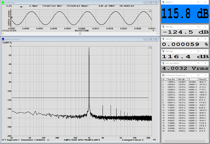

On the left, you have the Oscillo and the Spectrum.
Immediately to the right, you have the most relevant DDPs.
My goal is to snapshot this left area and attach it to illustrate the equipment review.

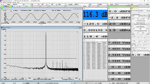

As you can see, to the right to this and just on the left of the generator, there are some other (U)DDPs, either filled from external (DMM => .Net => SETUDDP() - Thanks for that !), by formula, or internaly.
They will be usefull for more in-depth check of the measurements by interested people (and the full screen will therefore be attached to the review)
According to the actual test case, I plan to move some of the right UDDPs above the DDP Array (and shrink it accordingly) and hide the useless ones.
For a DAC, I need the DAC Output Voltage
For and ADC, the ADC input is relevant
For a Mic Preamp, the DUT Gain and DUT Input voltage are the key ones
So by programming this "window move", I can dynamically adapt the Screen
And maintain only ONE Panel setting (that I can not edit otherwise).
