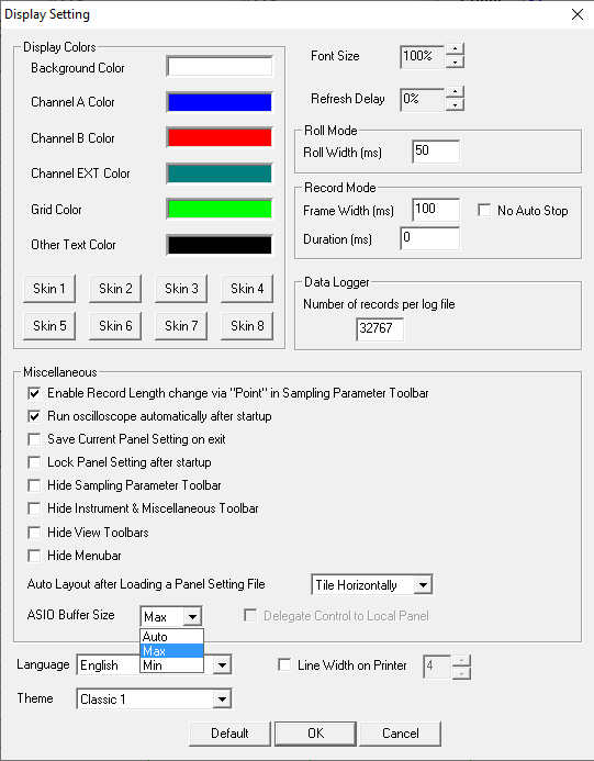

By default, Multi-Instrument will set the ASIO buffer size to Maximum. This helps the software to buy some time to perform some extra processing such as software triggering. Some hardware may not follow ASIO standard strictly, which causes "Buffer Size Exceeded" when the maximum buffer size is requested. You can change the default ASIO buffer size via [Setting]>[Display]>"ASIO Buffer Size".

This is the first thing I tried: Change this setting.
Unfortunately, it doesn't help.
I tried the 3 options. I also made sure the Topping driver was selected with same number of bits than MI
That still doesn't work.

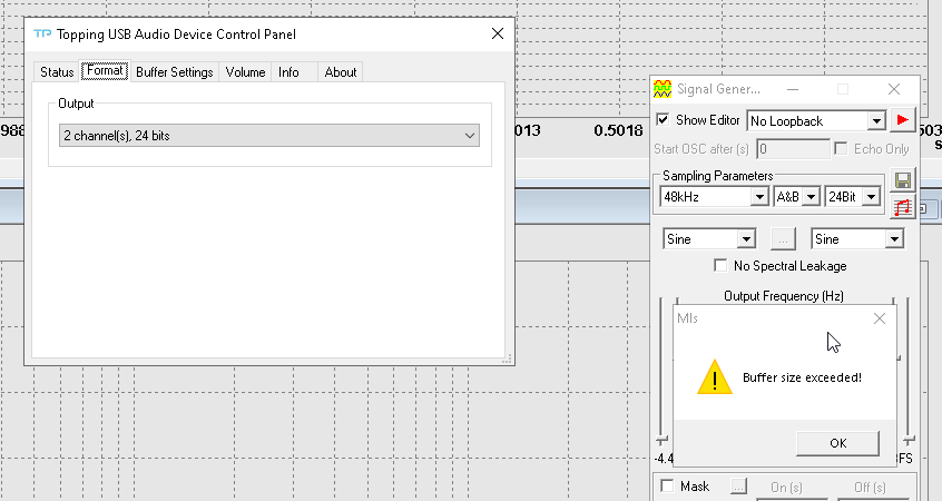

This is still not working with latest version of Topping driver (5.50 - https://www.topping.audio/newsinfo/759417.html)
REW works fine.
Wavelab 11Pro works fine.
Foobar2000 works fine.
Reaper works fine.
Only Multi Instrument doesn't work.
Any idea what I should check ?

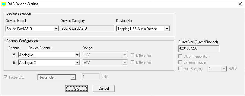

That is strange if you have tried all the three options: Max, Auto and Min for both Oscilloscope and Signal Generator. The Max and Min options use the maxSize and preferredSize returned by the ASIO driver directly. Not sure whether it returns a correct size. Could you please show the Buffer Setting tab of Topping USB Audio Device Control Panel?

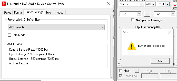

Postby RJA4000 » Sat Nov 05, 2022 4:52 pm
What do you mean by "for both Osclloscope and generator" ?
I just added a driver for Fiio BTA30 pro (DAC driver, with ASIO), and I have the exact same phenomenon
Buffer Size.PNG (12.58 KiB) Viewed 108625 times
This error shows only when I start the generator.
Of course, both devices are DAC only. Not ADC.

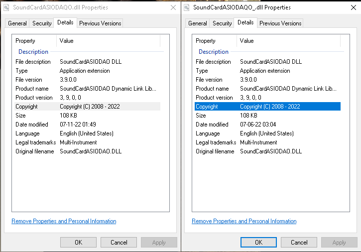

Postby RJA4000 » Mon Nov 07, 2022 9:02 am
I just did that.
But I see nothing different.
Still the same error message.
NB: Both DLLs have the same size

Postby RJA4000 » Tue Nov 08, 2022 2:37 am
thanks for your efforts !
Much appreciated.
There should be a third place, though.
Since I still get the same message with your latest DLL, with no pop-up...
Still, I checked, and they are all different.
