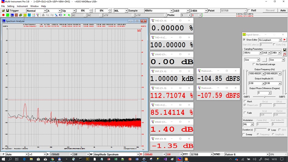

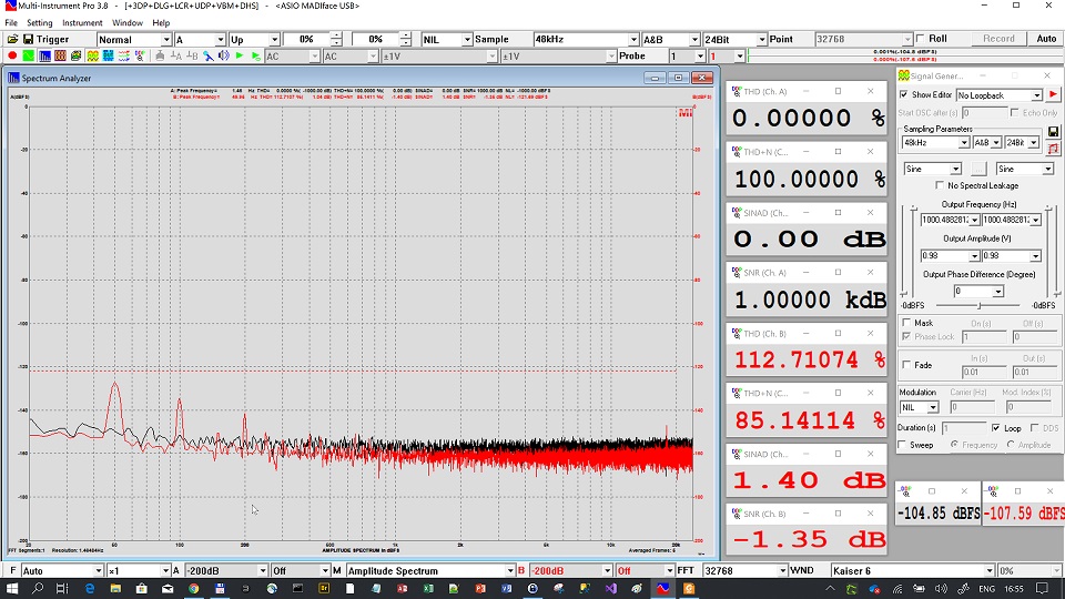

OK, but the "Tile" functionality has a big drawback:
My panel settings look like this
but after Tile, I get this
VirtinsTech wrote:7. The font size in the window title bar can be configured through windows control panel.

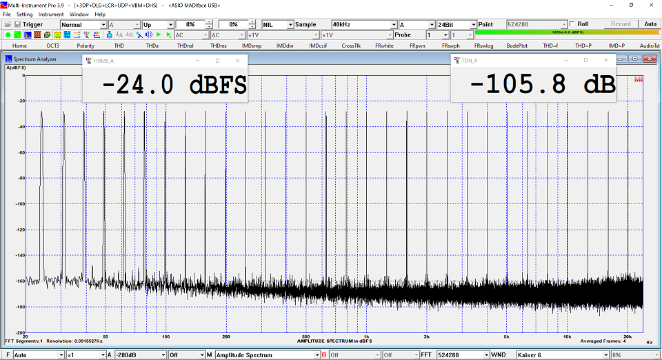

About Multi tone TD+N, from ARTA software manual:
"TD+N is the percentage of the square root of the ratio of power of all noise bins to
the power of multitone. Intermodulation distortion in Square+sine mode is expressed as DIM
Idea is to associate a figure to the Noise and distortion measured with a 32 1/3 octave Multitone signal, by removing all he 32 tones and measuring what's left.
Weighting that may be a valuable option.

TD+N has been added in the newly released MI 3.9. Thanks for the suggestions.
MI 39 TDN 25.png (175.44 KiB) Viewed 436556 times
