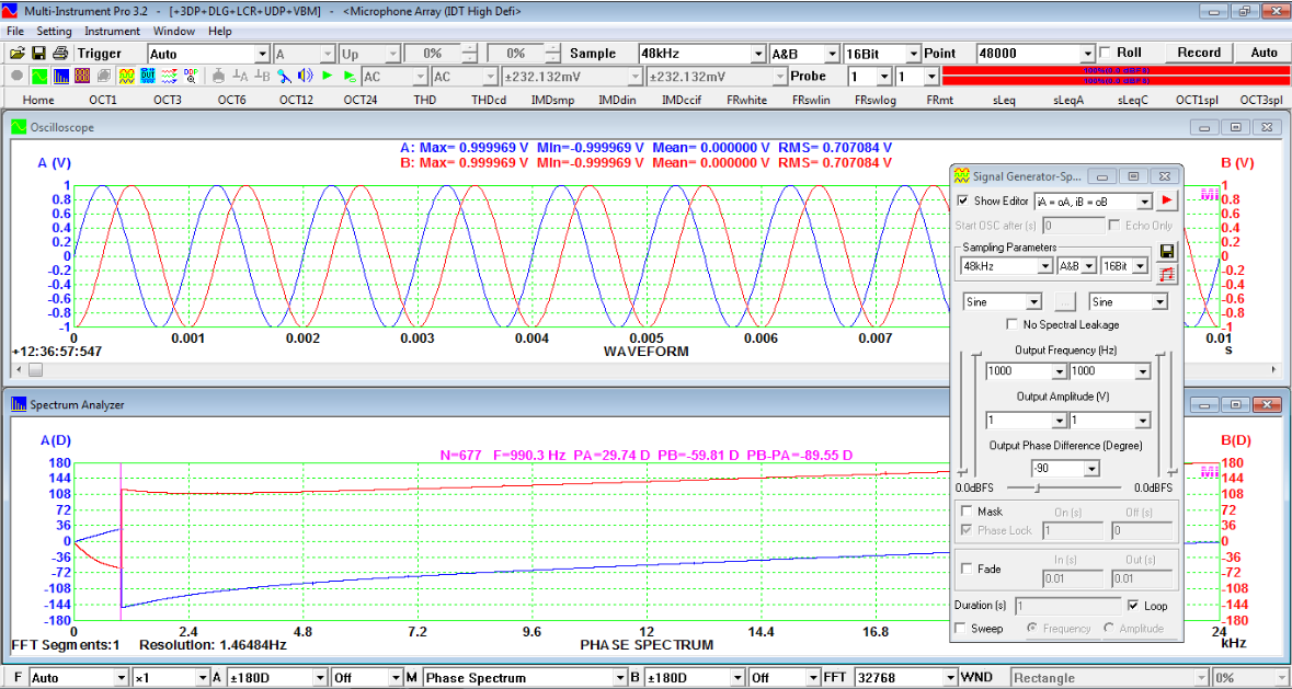

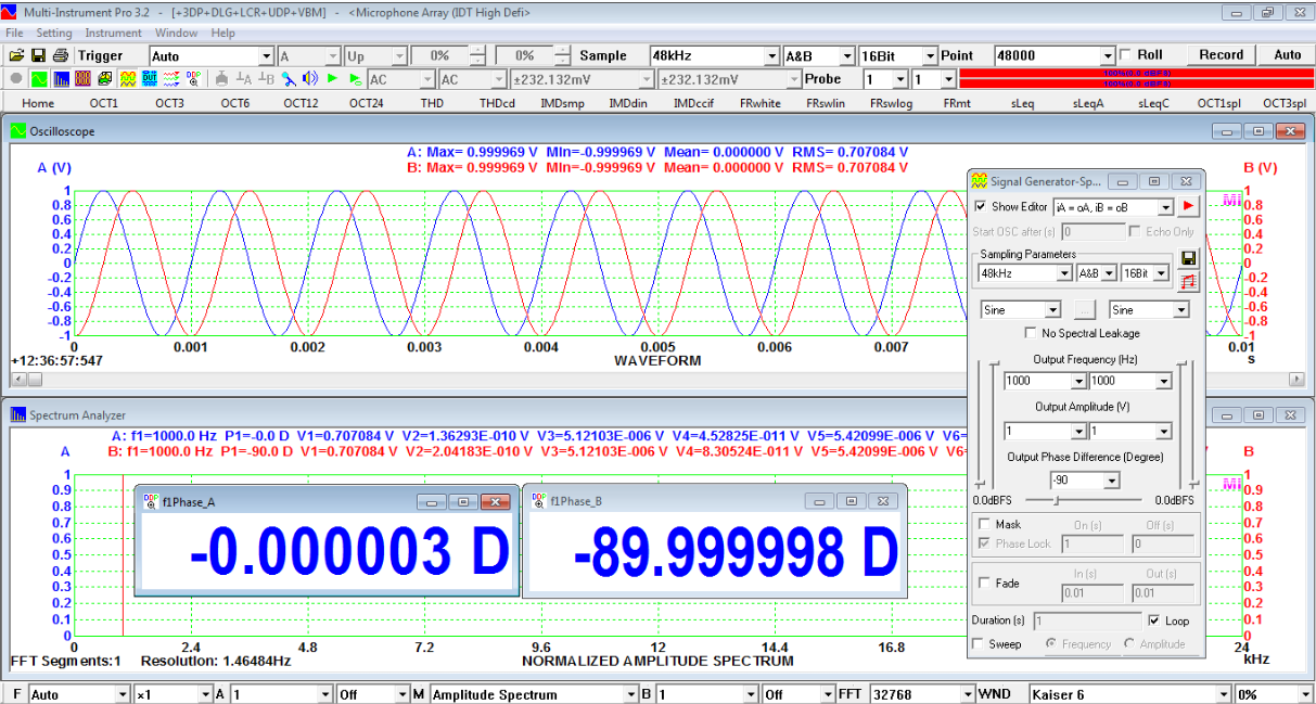

2/ a simple multi-meter display of the phase difference between input A and B, useful when aligning the heads on a tape machine.
Yoddom
Thank you for the suggestions.
1. It will be considered in future version.
2. There are two methods to measure the phase difference between the two channels.
(1) Use the phase spectrum together with the cursor reader to read the phase difference at a particular frequency.
Example:
(2) Use the "Harmonics" option in the Spectrum Analyzer to measure the phase of the fundamental frequency (refer to Section 3.3.2.8.3.5 of the software manual)
Example:
