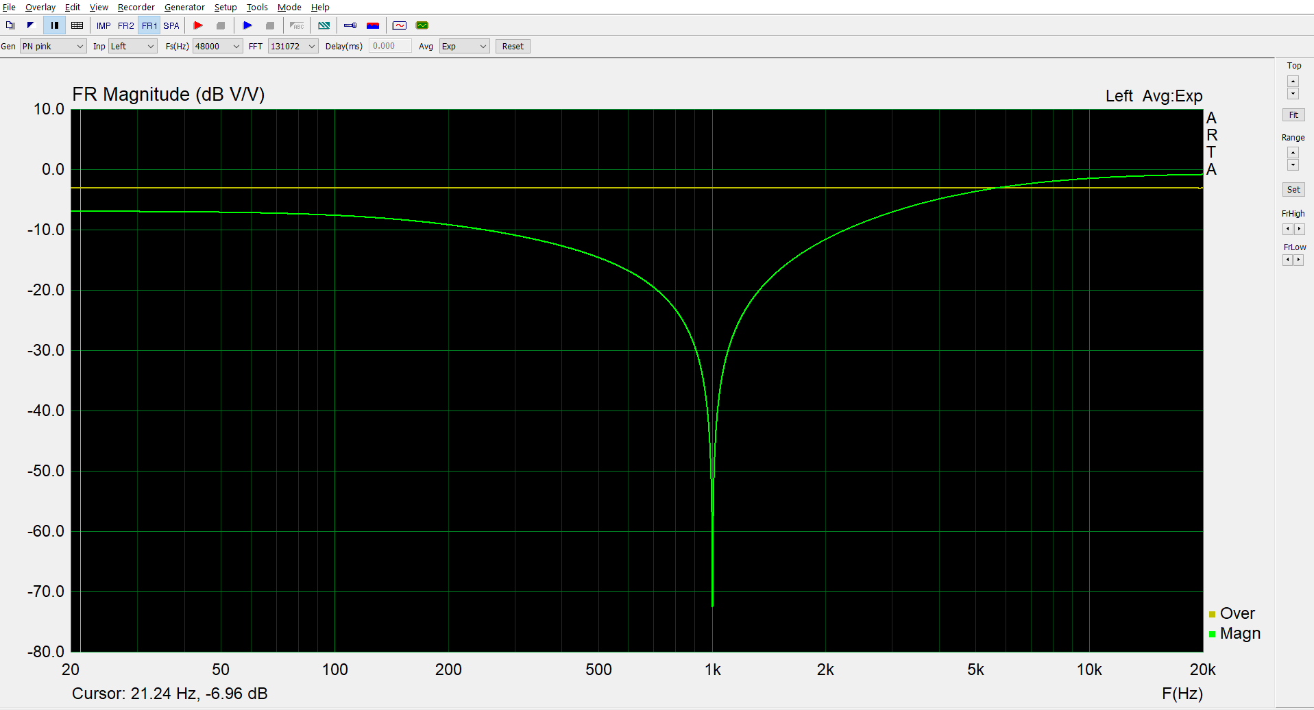

With ARTA I have a very clean graph with Frequency Response and FFT-131072. A clean -60db falling.

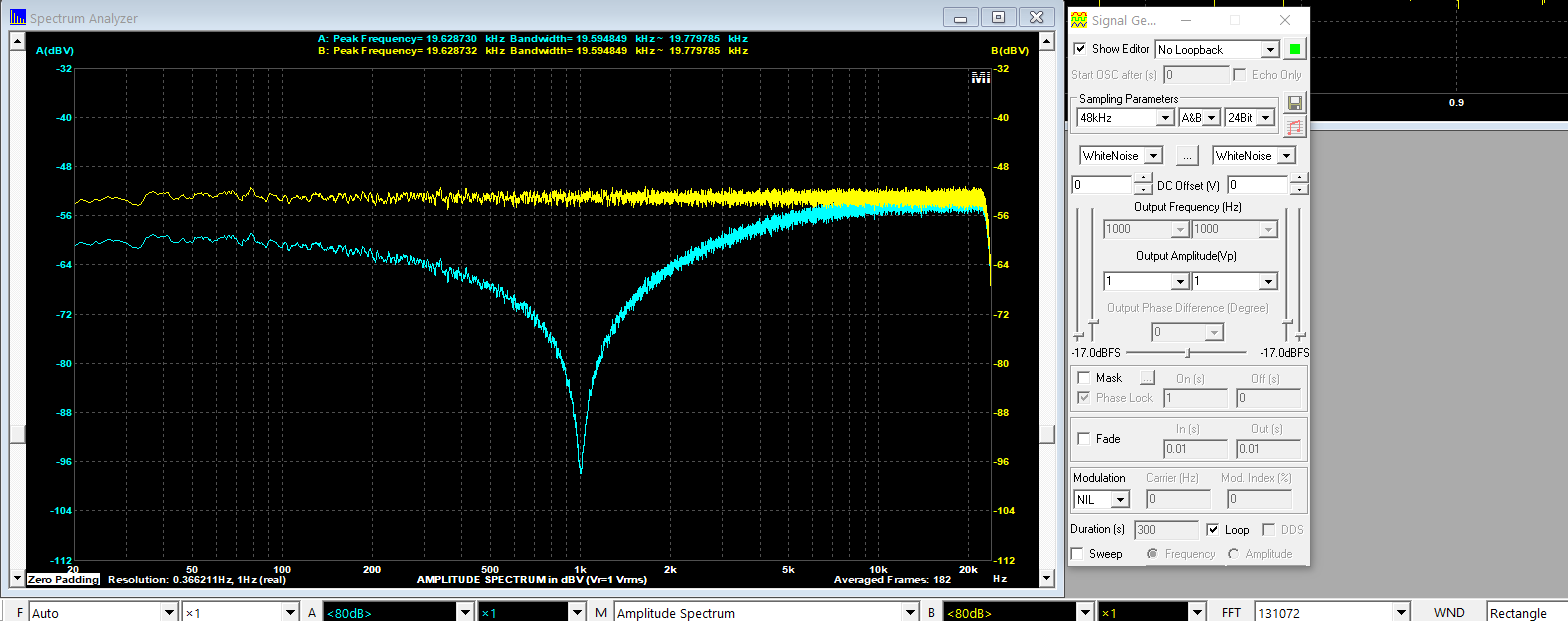

Frequency Response with white noise was good (almost -45dB fall) but the noise filter graph don;t touch the reference channel 2, lke ARTA at the same frequency...something wrong and with it.

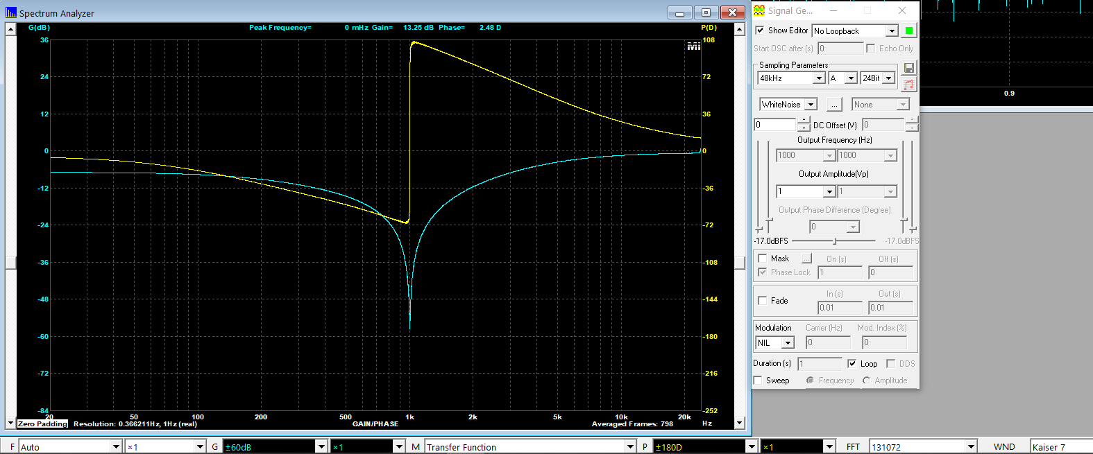

Finally, I tried with BodePlot again, with Kaiser window and FFT-131072.

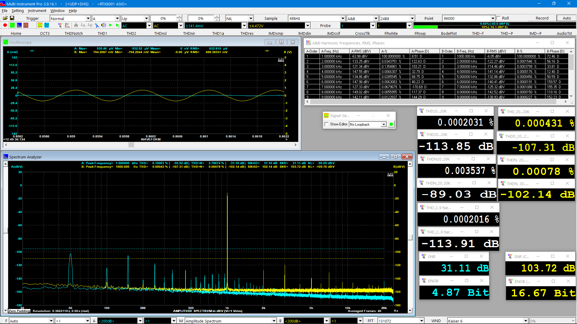

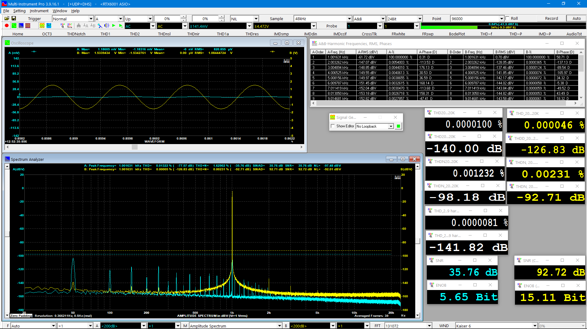

This is the best that I achieved, a -50dB fall. I take a compensation file from this and I done two SE THD measurements one with RTX6001 (loopback with notch) and the other with EOS1KV Oscillator (with notch).
I think than I am good now, and my effort must to concentrate how to remove the harmonics of 50Hz (hum).

- ARTA.png (79.97 KiB) Viewed 13757 times
- Mi-Pro whitenoise.png (59.49 KiB) Viewed 13757 times
- BodePlote Mi-Pro.png (60.13 KiB) Viewed 13757 times

- THD SE RTX6001, 1Vrms.png (139.49 KiB) Viewed 13757 times
- THD SE EOS1KV oscillator, 1Vrms.png (141.42 KiB) Viewed 13757 times

It appears that your magnitude frequency response measurement used periodic pink noise (PN Pink) as the stimulus together with wide-band octave analysis in ARTA. This differs from using true white noise excitation with narrow-band FFT analysis in Multi-Instrument. Similar to frequency sweeping methods, periodic white or periodic pink noise methods do not require averaging and therefore converge very quickly. In contrast, true random noise methods require long-time averaging to obtain a smooth curve, especially when the frequency resolution is high. To obtain a smooth and accurate frequency response curve in a short time, you can use the “FRswp” button preconfigured for RTX6001. It uses a logarithmic frequency sweep combined with 1/96 octave analysis.
It is also possible to use a periodic noise as the stimulus. In Multi-Instrument, a periodic white noise or periodic pink noise can be generated using the Multitone mode in the Signal Generator. Please refer to Section 4.3.1.8.2.1 of the software manual for details.
1. For single-channel magnitude frequency response measurements:
Wide-band octave analysis should be used when the stimulus is logarithmic sine sweep, pink noise, or periodic pink noise.
Narrow-band FFT analysis should be used when the stimulus is linear sine sweep, white noise, or periodic white noise.
2. For dual-channel Bode plot measurements, only narrow-band FFT analysis is supported in Multi-Instrument. Direct THD/THD+N measurement in Ch.A with the compensation GPC file loaded and without using UDDP calculation is possible only if the Bode plot is measured accurately and with high precision.
