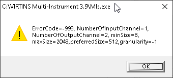

Now I see something
2022-11-10 06_58_33-C__VIRTINS Multi-Instrument 3.9_MIs.exe.png (3.74 KiB) Viewed 204228 times
I have exactly the same error with the Topping driver and the Fiio driver.
I may change the "preferred size" by setting the driver's buffer size directly.

Thanks a lot for the information. It definitely helped. Could you please try this updated one at: https://www.virtins.com/FileDelivery/So ... IODAQO.dll

Now that works !
For both: the Topping and the Fiio
Thanks !
