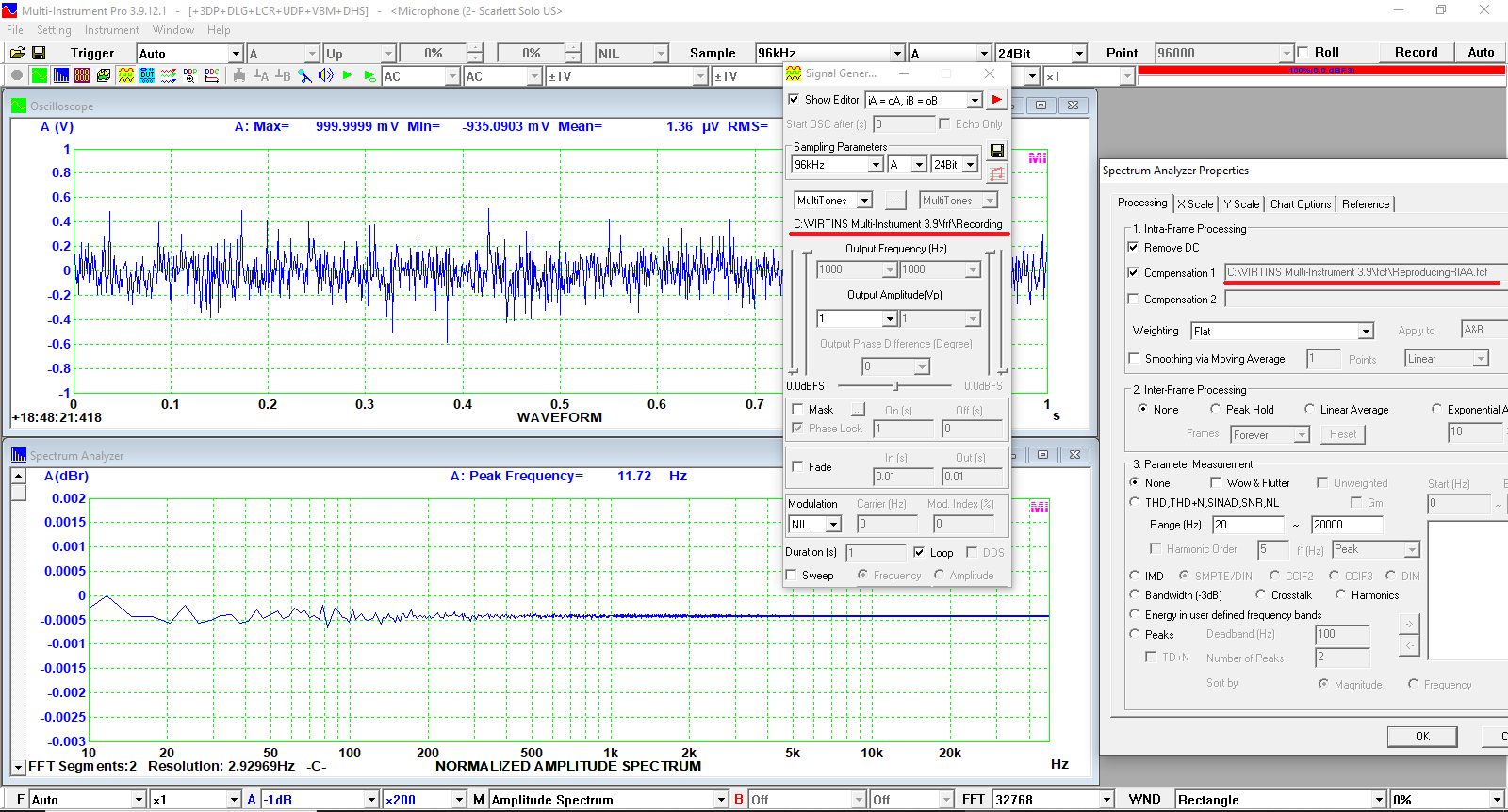

Sorry, I am having a bit of trouble understanding your English. As shown previously, the RIAA curve can be obtained with a high resolution (>=32768 points) within 1 second if a "periodic white noise" is used as the test signal.
In fact, in Multi-Instrument, you could use Recording RIAA in the Signal Generator to generate an RIAA pre-emphasized "periodic white noise", and then apply Reproducing RIAA in the Spectrum Analyzer to deemphasize it. Ideally, the result should be a flat horizontal line, as shown below. Again, this can be achieved within 1 second.

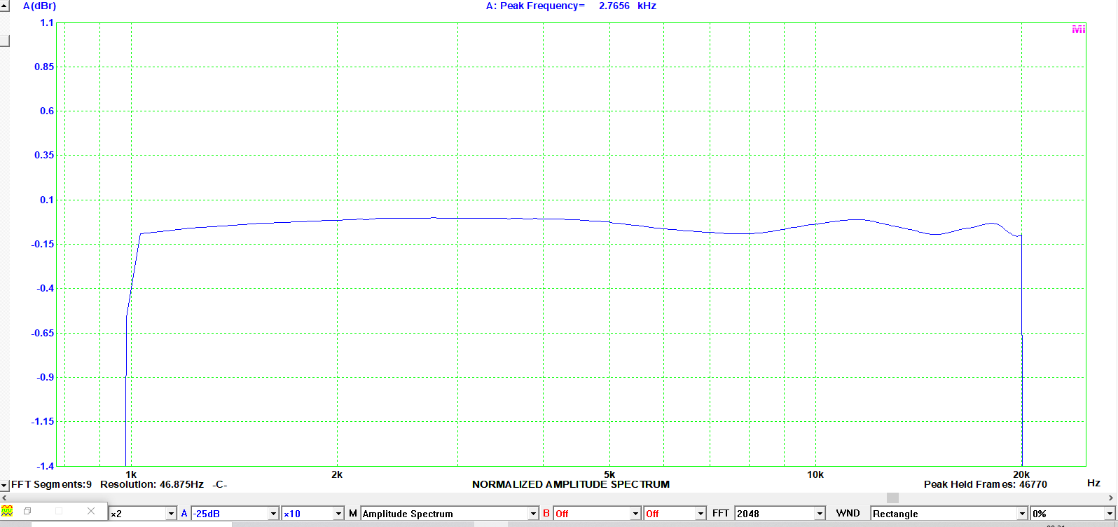

observe my level of precision of level ;-)
(observations rather around 0.05 0.1db etc.)

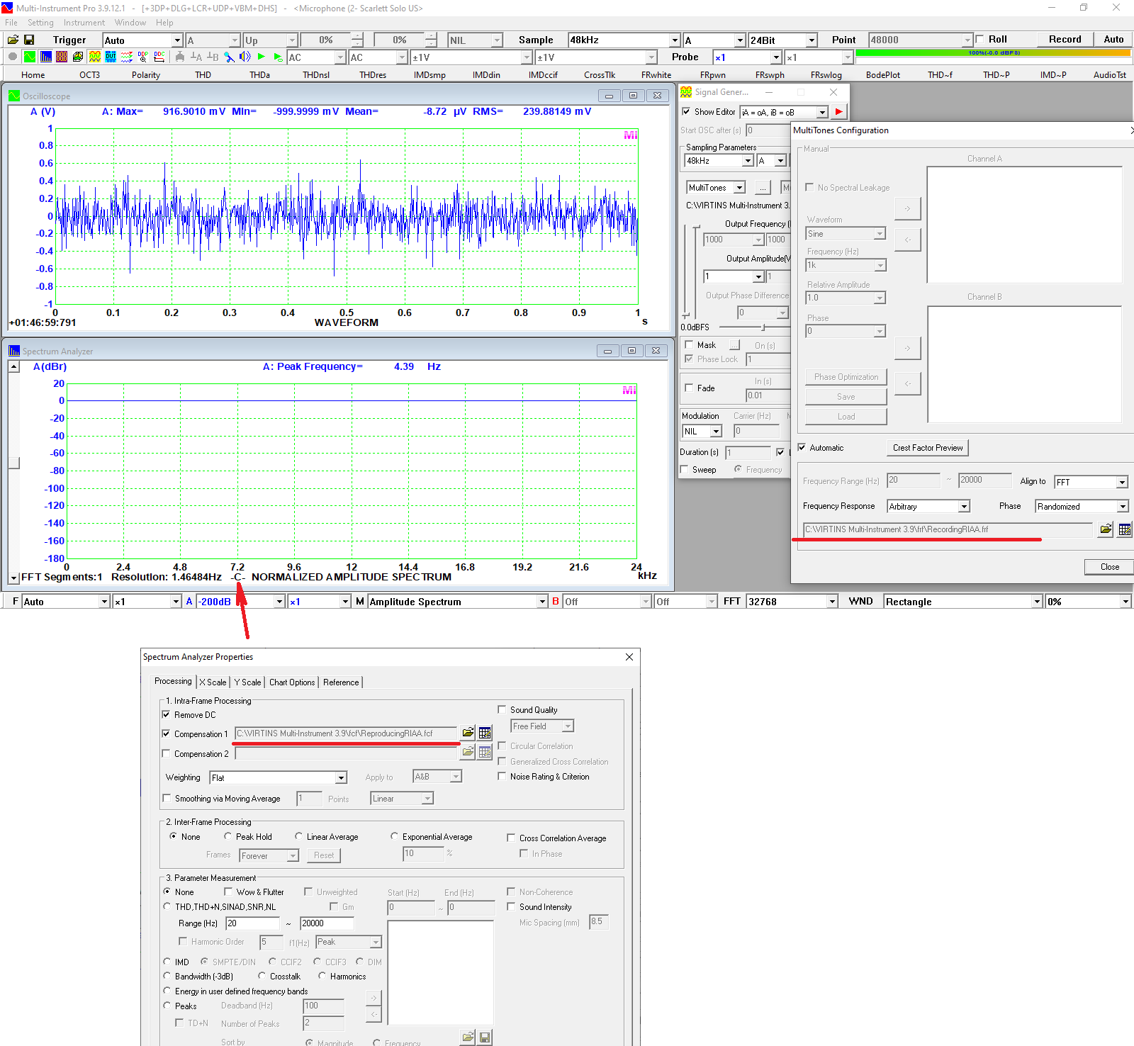

Posted: Sat Nov 09, 2024 7:43 pm
Thanks, I'm starting to understand what you meant. Yes, there are some minor discrepancies in the RIAA curve data across different software applications. If you generate an RIAA pre-emphasized "white" test signal from one application and then de-emphasize it with another, the resulting spectrum may display some minor artefacts due to these RIAA discrepancies. This issue can be avoided by using the same software for both pre-emphasis and de-emphasis, see figure below.
Please find attached the updated and more precise RIAA FCF and FRF files to be used in Multi-Instrument.

i try it and seem ok now...! top....
(here just to validate observe the behavior of a means of acquisition of fr above" 1-2k to 20k,or more", to observe the behavior and help to adjust somes parameters (capacitance etc) of mm cartridge etc, seems quite sufficient and rigorous for my use ;-) )
new riaa.PNG (45.54 KiB) Viewed 1253279 times
example
