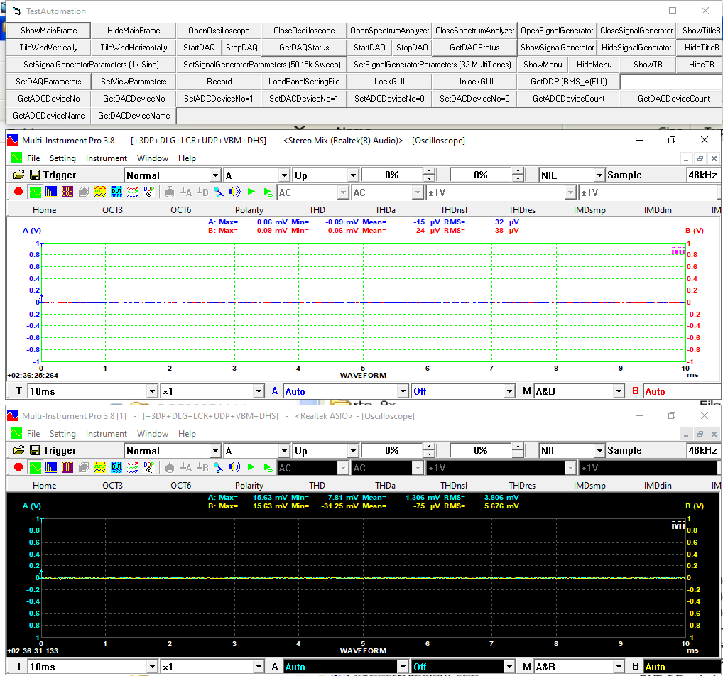

ActiveX automation client sample codes can be found in MI's AutomationAPIs folder. Those sample codes will launch only one MI instance. The following shows the modified Visual Basic codes for the launching of two MI instances.

The resulting screenshot is as follows:
