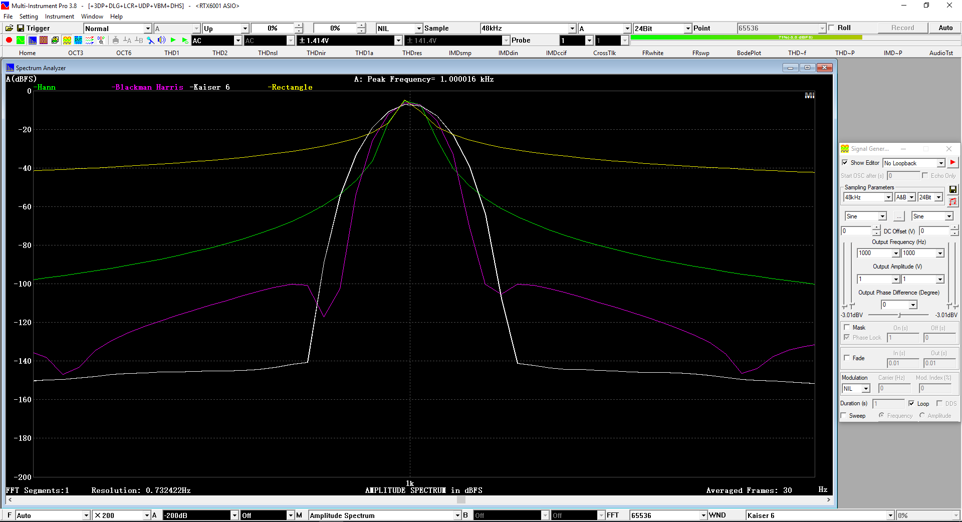

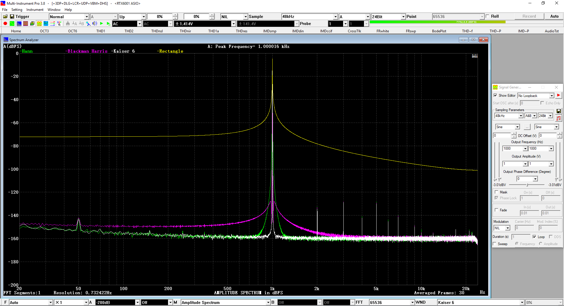

2. Spectral Leakage
Spectral leakage occurs when a FFT segment contains a non-integer number of signal cycles. It can be suppressed by applying a window function and using a larger FFT Size (and Record Length).
A window function helps to converge most of the power of a sinusoidal signal into a few FFT bins around its peak, leaving only a tiny amount of power leaking to FFT bins farther away. The following screenshot and its closeup show the spectra of a 1 kHz sinewave with different window functions applied: Hann, Blackman Harris, Kaiser 6 and Rectangle (i.e. no window function).
It can be seen that among them, Kaiser 6 is the best window function that has the least spectral leakage while Rectangle is the worst one with which all harmonics are submerged under the spectral leakage. Although it is possible to calculate audio parameters such as THD using Hann or Blackman Harris (for example, one can use a much wider bandwidth to compute the power of the fundamental when Hann window is used. But that also means that the noise power that falls into those FFT bins will be falsely taken into the fundamental’s account), the results will be compromised compared with those obtained using Kaiser 6. It is reasonable to expect that there will be some differences among the results using different window functions regardless what software calculation method is used after windowing. Only Kaiser 6 ~ Kaiser 10 and the like is recommended for THD measurement in MI.
Similarly, the larger the FFT size, the higher the frequency resolution (Note: [FFT frequency resolution]= [Sampling Rate]/[FFT size]), the more concentrated the sinusoidal power. The following screenshots shows the spectra of a 1kHz sinewave with different FFT sizes: 2048, 32768, 524288. The frequency resolutions are thus: 23.43Hz, 1.4648Hz, 0.091553Hz. The FFT bin bandwidth ratio is: 256: 16: 1. Assuming the noises are distributed uniformly along the frequency axis, the ratio of the noise power contained in each FFT bin is also: 256: 16: 1. In other words, there is a 12dB difference in the apparent noise floors in between among the three cases. This can be seen from the screenshot and its closeup below.
The apparent noise floor changes with FFT size. This is why MI shows the total noise level which does not change with FFT size in the spectra of THD measurements. In contrast to the noises, the heights of the peaks of sinusoidal components remain almost unchanged with FFT size and thus become visible or more prominent above the apparent noise floor as FFT size increases. On the other hand, the widths of the peaks of sinusoidal components become narrower (thus sinusoidal power is more concentrated) as FFT size increases, separating the noise and signal more clearly. It is thus reasonable to expect that there will be some differences among the results using different FFT size regardless what software calculation method is used, and generally, the measurement accuracy will improve as FFT size increases. Otherwise there would be no point to increase FFT size. The differences caused by different FFT sizes (in a certain range, of course) should be small, though.

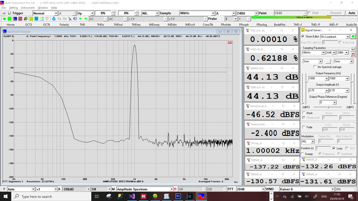

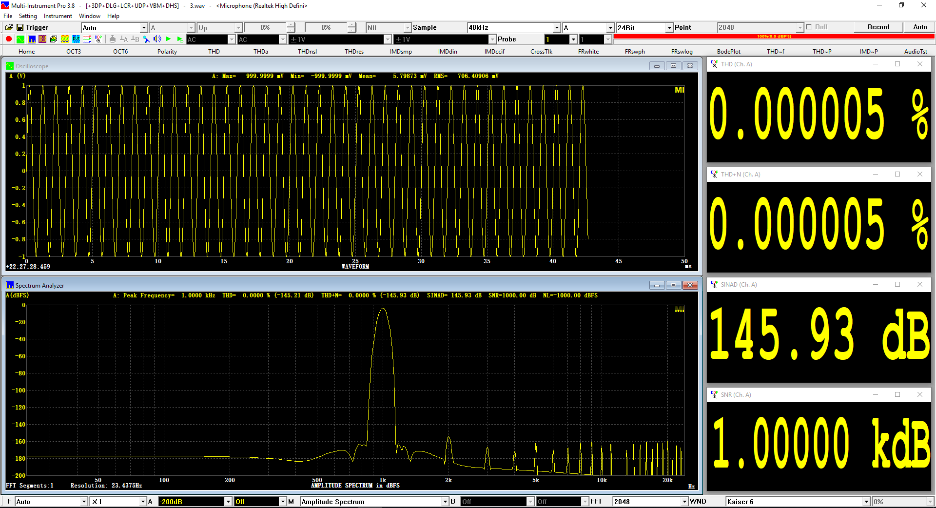

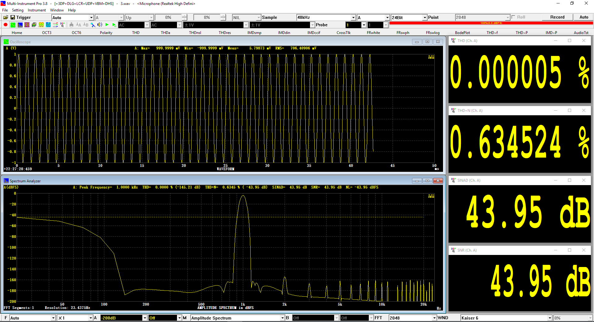

So I have the answer to the first case:
Spectral leakage
Spectral leakage
FFT Size MI 2k Leak.jpg (245.65 KiB) Viewed 389929 times
It's pretty clear there is a DC offset due to spectral leakage.
Which we see fixed here:
FFT Size MI 2k No Leak.jpg (255.78 KiB) Viewed 389929 times
That's covered by your explanation #1

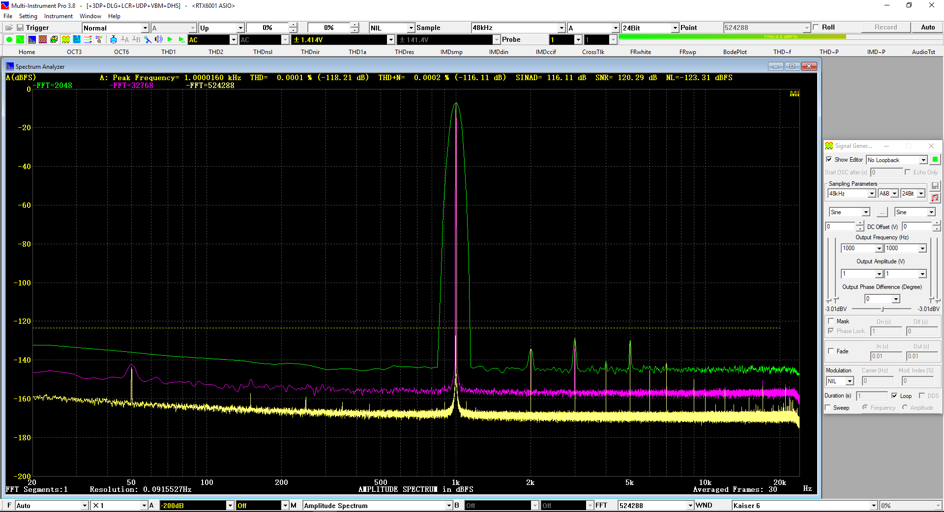

Second, it's also clear that the last case, with FFT size of 1024k is related to a PC performance issue:
As the processing takes longer, my PC is generating non-stable signal, and therefore we have lower performance.
That may appear also when I change window or do something else on the PC while the measurement is on-going.
That's not specific to Multi Instrument.
(What is specific though is that it seems to take longer for MI to process such a huge FFT window)
Obviously, I have to take a look at the PC and optimize the drivers and other background jobs.
That's what you highlighted at the end of your post, and I agree.

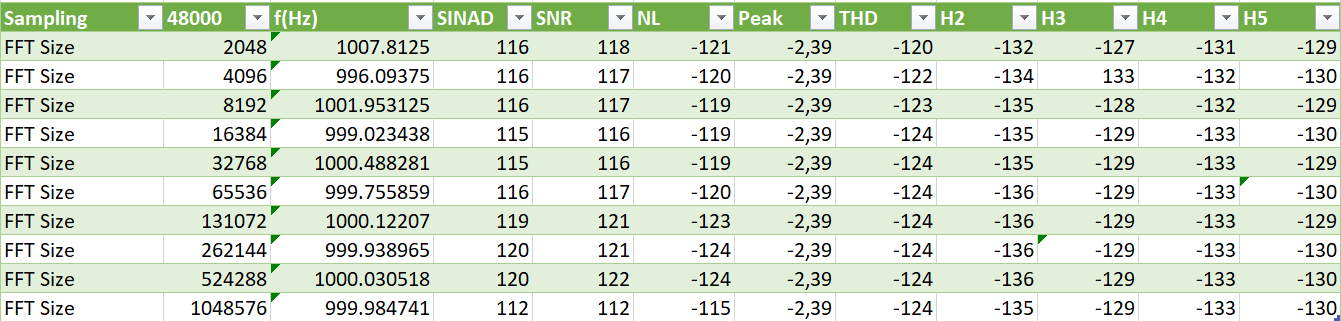

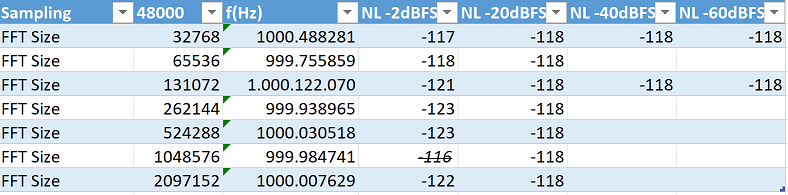

But what I still don't understand is the big different in Noise Level figure between, say, a FFT of 32768 and 131072.
We jump from -119dB to -123dB (unweighted).
MI Table.PNG (35.42 KiB) Viewed 389929 times
That doesn't look like "small differences" as you were describing here:
VirtinsTech wrote:The apparent noise floor changes with FFT size. This is why MI shows the total noise level which does not change with FFT size in the spectra of THD measurements. In contrast to the noises, the heights of the peaks of sinusoidal components remain almost unchanged with FFT size and thus become visible or more prominent above the apparent noise floor as FFT size increases. On the other hand, the widths of the peaks of sinusoidal components become narrower (thus sinusoidal power is more concentrated) as FFT size increases, separating the noise and signal more clearly. It is thus reasonable to expect that there will be some differences among the results using different FFT size regardless what software calculation method is used, and generally, the measurement accuracy will improve as FFT size increases. Otherwise there would be no point to increase FFT size. The differences caused by different FFT sizes (in a certain range, of course) should be small, though.
The apparent noise floor is changing, for sure, but the SNR or Noise Level should not, or by a very limited amount.
Which is what you confirm here :
4dB or even 5dB difference doesn't look small.

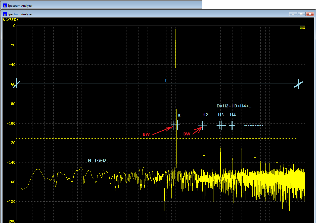

The total power (T) of the signal consists of three parts: fundamental of the signal (S), harmonic distortion (D=H2+H3+H4+...), noises (N), i.e. T = S + D + N. THD, THD+N, SNR, SINAD, NL are derived based on the measurement of these three parts. T can be readily calculated by summing up the power in all FFT bins in the specified frequency range of interest (e.g. 20Hz~20kHz). The power of a sinusoidal component (e.g. S, H2, H3, H4…) can be calculated from a few FFT bins around its peak (See figure below).
The bandwidth (BW) that is used to calculate the power of a sinusoidal component reduces as FFT frequency resolution increases. As a result, the measurement accuracy increases. The BW is usually software algorithm dependent. The following two examples illustrate how BW can be selected and its impact on S,D and N calculation.

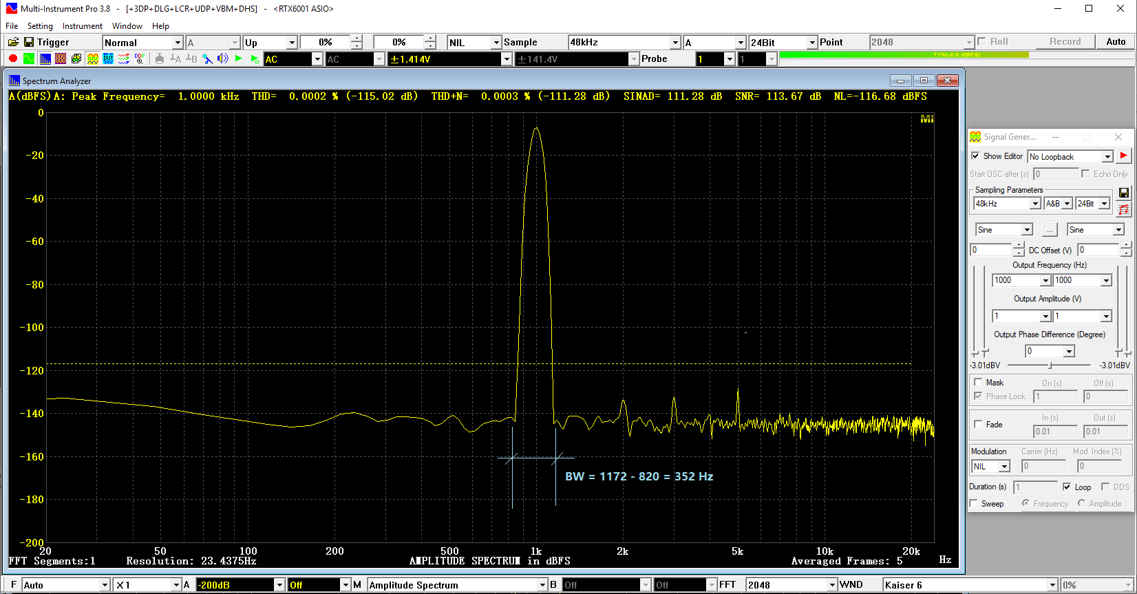

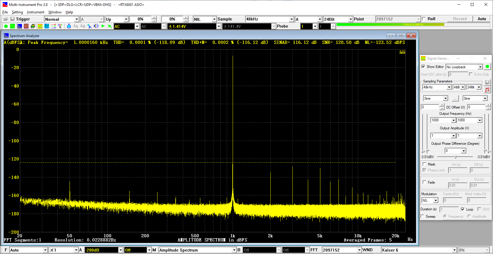

1. [FFT Size] = 2048, [Frequency Resolution] = 23Hz
THD = -115.02dB, THD+N = -111.28dB, SINAD = 111.28 dB, SNR =113.67dB, NL = -116.68 dBFS
The BW in this case is 1172Hz-820Hz=352 Hz which can be clearly seen from the width of the fundamental peak. This is pretty coarse as the noise that falls into this BW will be falsely taken as a part of the fundamental or harmonic power.

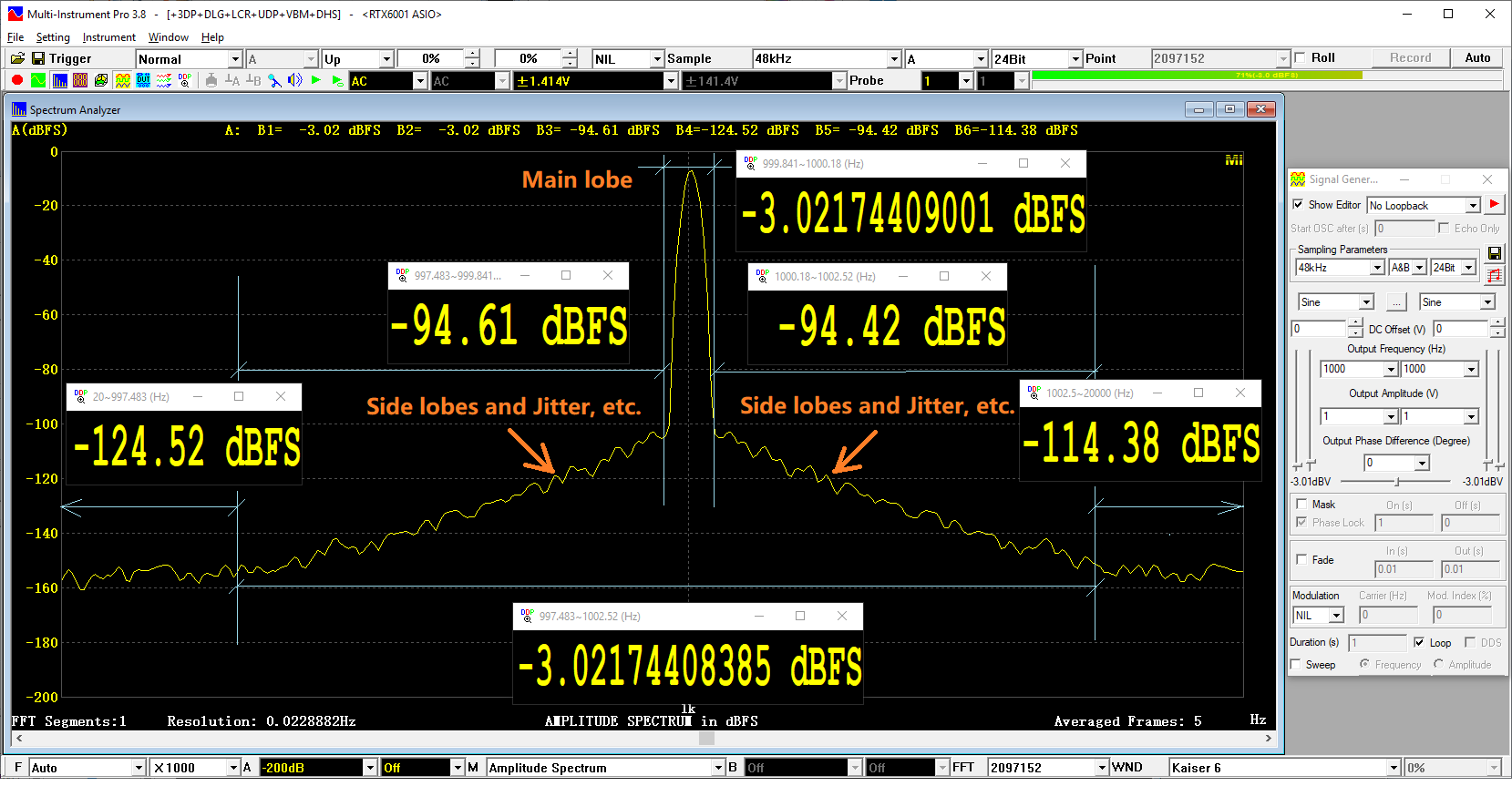

2. [FFT Size] = 2097152, [Frequency Resolution] = 0.023Hz
THD = -118.09dB, THD+N = -116.12dB, SINAD = 116.12 dB, SNR =120.50dB, NL = -123.52 dBFS
The BW in this case is 1002.52Hz – 997.483Hz = 5Hz. The corresponding S=-3.02174408385 dBFS, as shown in the close-up of the fundamental peak.
Now, if we use Kaiser 6’s main lobe width BW =1000.18Hz - 999.841Hz=0.339 Hz for the fundamental power calculation instead, then S=-3.02174409001 dBFS. The difference between the two methods is negligibly small (only 0.00000000616 dBFS) for the fundamental power calculation. However, this will cause big difference in noise level calculation, because the power levels in the frequency bands 997.483Hz ~ 999.841 Hz and 1000.18Hz ~ 1002.52Hz are -94.61dBFS and -94.42 dBFS respectively, much higher than the measured noise level -123.52 dBFS. In other words, a slightly-narrower-than-proper BW can falsely increase the noise level significantly. On the other hand, due to the nearly uniform distribution of noises, a slightly-wider-than-proper BW will be on the safer side and has minimum impact on the results. The picture also shows the power level in the frequency bands 20 Hz ~ 997.483 Hz and 1002.5Hz~20000Hz are -124.52 dBFS and -114.38 dBFS (note: this one contains both noise and harmonic distortion in this frequency band) respectively. The above power levels are calculated using [Spectrum Analyzer Processing]>"Energy in User Defined Frequency Bands" in MI.
The noise level difference in the above two examples is -116.68 dBFS - 123.52 dBFS = 6.84 dBFS. if you want Example 2 to measure the same noise level as Example 1, then the BW have to be reduced, which does not look correct from the spectrum, especially when a much wider BW is actually used in Example 1.
The skirts of the harmonics are usually buried under the noise floor and thus do not account for the above noise level difference.
In summary, the measurement accuracy will be improved with a larger FFT size, because the larger the FFT size, the higher the frequency resolution, the narrower the BW required, the better segregation of S, D and N. Whether the improved measurement accuracy will lead to better or worse audio parameters depends on the spectrum details, in particular the skirt of the fundamental.

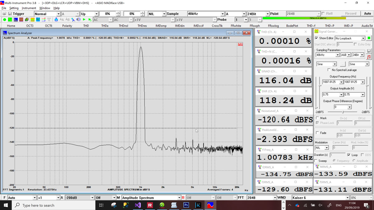

I've performed some more tests.
First, I've redone same tests.
Then I've checked with varied level.
Here is the variation of Noise Level:
FFT Size and Level_.png (76.08 KiB) Viewed 389837 times
(Note that -2dBFS 1024k size measurement was not stable and should be removed)
As one can see, the Noise level varies quite a lot with the FFT Window size when level is at -2.4dBFS (pretty similar to my previous measurements)
But it's stable when you lower the level.
Does that mean that the distortion components (which are higher with higher level) are taken into account differently as the FFT window size changes ?
Or is it the fundamental removal which impacts the NL differently ?

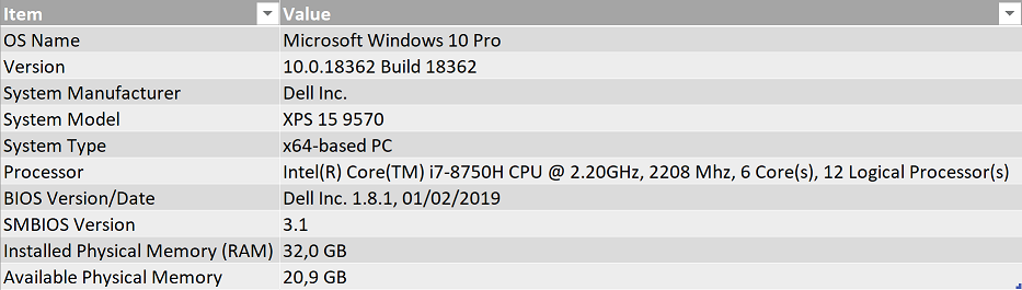

And here is the PC config:
PC Infos.PNG (97.83 KiB) Viewed 389837 times
