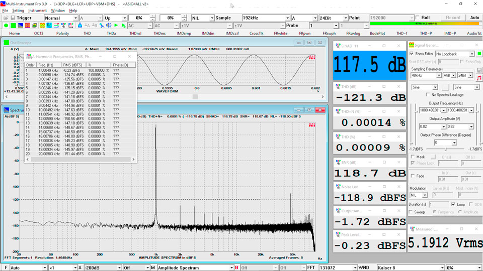

4. (4)
The software automatic re-arrangement is screwing my own arrangement.
As an example, I build this type of screen. I'd like to have a way to align the UDDP boxes as requested.
(You also see in this example a UDDP I'd like to write to in the bottom right.)

Another question, by the way:
In the example I posted above, you can see that Distortion phases are not displayed.
This seems to be always the case when you perform an inter-frame average.
Is that on purpose or would that be possible to fix that ?

RJA4000 wrote:Another question, by the way:
The measured phase in Multi-Instrument refers to the initial phase (i.e. the phase of the leftmost sample of an Oscilloscope data frame) of a sine function. In the current version, the phase information will not be available under either of the following conditions:
(1) when Intra-frame averaging or zero-padding is performed automatically by the software
a. When [Record Length] < [FFT Size], zeros will be padded at the end of the data frame automatically, no phase information will be provided.
b. When [FFT Size]<=[Record Length]< (2 x [FFT Size]), no zero padding and no intra-frame averaging, thus phase information will be available.
c. When [Record Length] >= (2 x [FFT Size]), intra-frame averaging will be performed automatically, phase information will be lost.
(2) when Inter-frame averaging is performed and the averaging with the second data frame has been done.
Phase information will only be available for the very first data frame. This is because there is no guarantee that the second data frame and those after will have the same initial phase, depending on the trigger setting and the ratio of [Sampling Rate] to [Signal Frequency], etc. Therefore, averaging on phase may not improve the phase measurement accuracy.
In the coming new version, the limitation of the above (1)a and (1)c will be removed. (2) will be modified to make the phase information of the very first data frame available during the whole process of inter-frame averaging.
