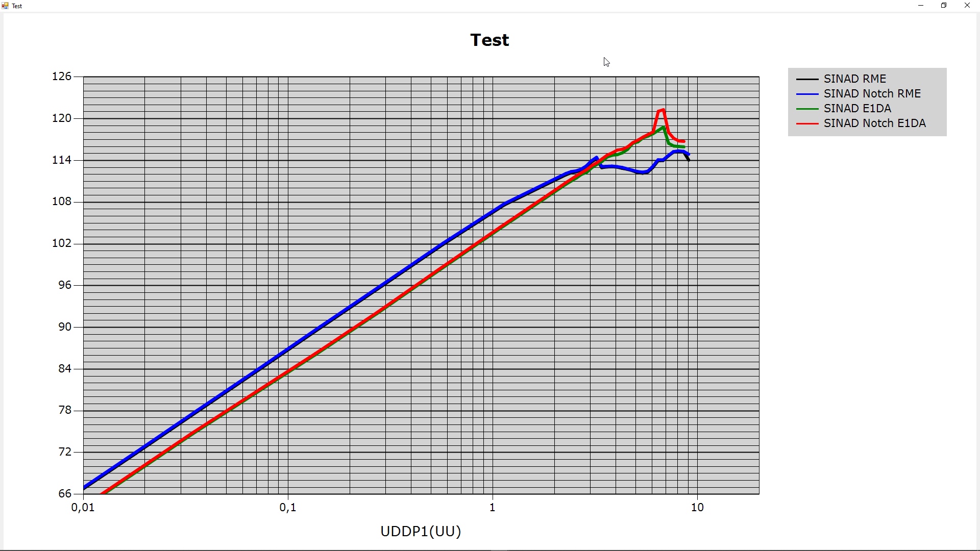

Posted: Tue Jul 19, 2022 1:25 am
I'm still struggling with this one.
As an example, I compare the results for the same DAC with 2 different ADCs, and compared results from my "home made " SINAD to the "Official" SINAD
2022-07-18 12_52_44-AES-17 Notch debug.png (109.18 KiB) Viewed 335188 times
(X axis are Vrms - sorry for that, it was just a "quick and dirty" plot)
There is some coherent results:
When DAC and ADC are in the same machine (the RME), there is no difference of result between both methods, which is to be expected.
When the ADC is separate, we see a small gap... until it suddenly explodes at between -3.0dBFS and -2.5dBFS...
So what's going on at -2.5dBFS ?

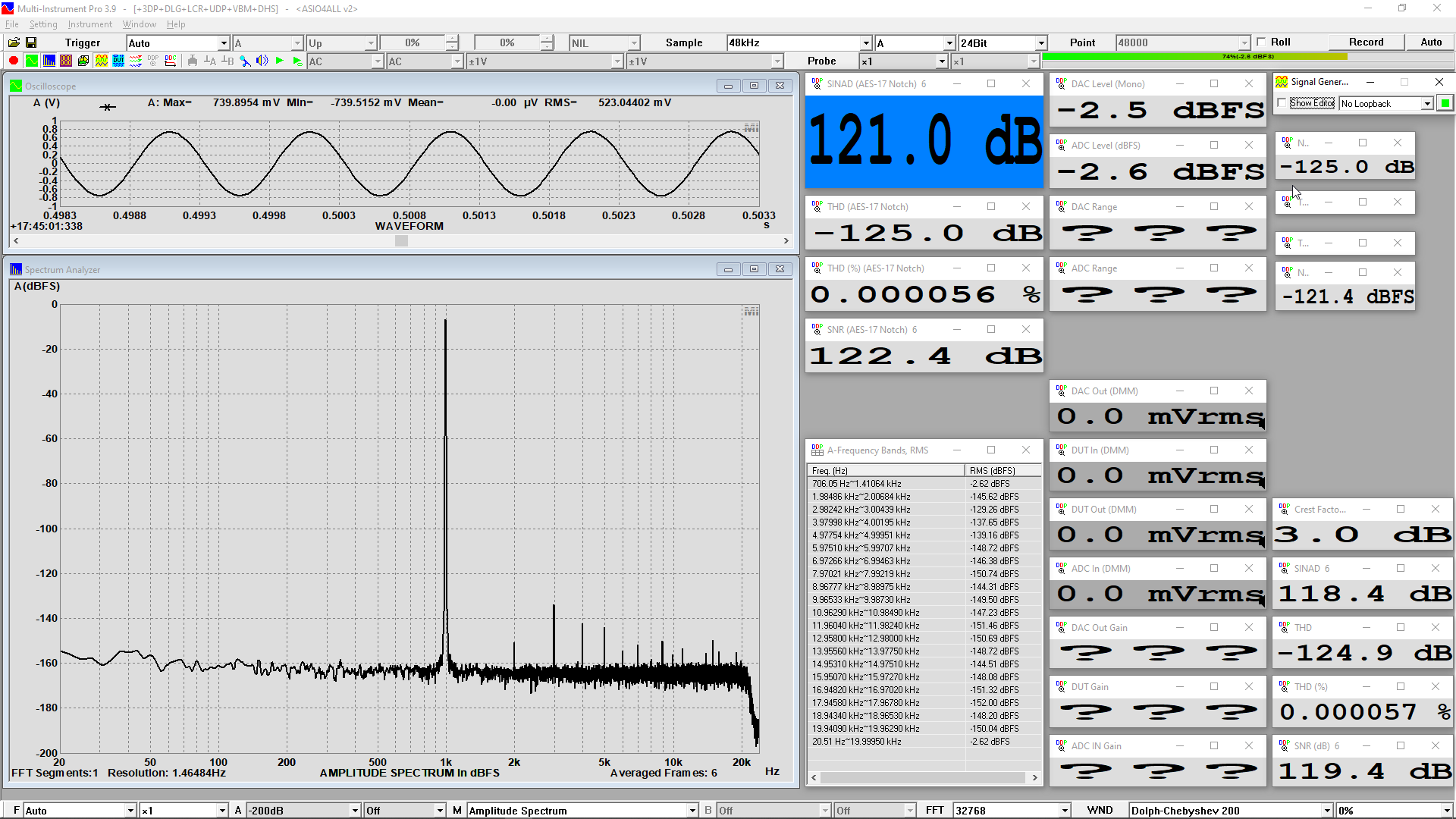

2022-07-18 17_45_07-MI Notch -2.5dBFS.png (158.31 KiB) Viewed 335188 times

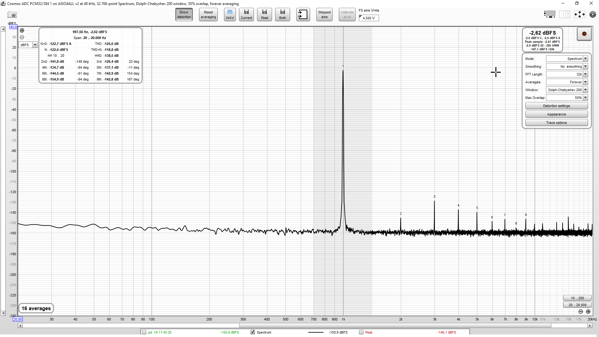

I compared with REW (AES-17 notch)
2022-07-18 17_51_27-Cosmos ADC PCM32_384 1 on ASIO4ALL v2 at 48 kHz, 32.768-point Spectrum, Dolph-Ch.png
2022-07-18 17_51_27-Cosmos ADC PCM32_384 1 on ASIO4ALL v2 at 48 kHz, 32.768-point Spectrum, Dolph-Ch.png (189.42 KiB) Viewed 335188 times
The main difference is on the noise.
You see my bands here:
;A-Frequency Band (Hz), A-RMS (dBFS)
706.055Hz ~ 1410.64Hz, -2.61886
1984.86Hz ~ 2006.84Hz, -145.616
2982.42Hz ~ 3004.39Hz, -129.26
3979.98Hz ~ 4001.95Hz, -137.651
4977.54Hz ~ 4999.51Hz, -139.163
5975.1Hz ~ 5997.07Hz, -148.723
6972.66Hz ~ 6994.63Hz, -146.379
7970.21Hz ~ 7992.19Hz, -150.739
8967.77Hz ~ 8989.75Hz, -144.307
9965.33Hz ~ 9987.3Hz, -149.503
10962.9Hz ~ 10984.9Hz, -147.226
11960.4Hz ~ 11982.4Hz, -151.459
12958Hz ~ 12980Hz, -150.691
13955.6Hz ~ 13977.5Hz, -148.718
14953.1Hz ~ 14975.1Hz, -144.512
15950.7Hz ~ 15972.7Hz, -148.078
16948.2Hz ~ 16970.2Hz, -151.32
17945.8Hz ~ 17967.8Hz, -151.996
18943.4Hz ~ 18965.3Hz, -148.199
19940.9Hz ~ 19962.9Hz, -150.035
20.5078Hz ~ 19999.5Hz, -2.61886
The last one being full bandwidth.
(By the way: is the upper frequency bin included in the result for the band or not ? It seems it's not.
As an example 11960.4Hz ~ 11960.4Hz gives me -[infinity] result.)
I compute noise level as follows:
10*LOG10(
10^([fnRMS_A(EU)_Array[20]]/10)
-10^([fnRMS_A(EU)_Array[0]]/10)
-10^([fnRMS_A(EU)_Array[1]]/10)
-10^([fnRMS_A(EU)_Array[2]]/10)
-10^([fnRMS_A(EU)_Array[3]]/10)
-10^([fnRMS_A(EU)_Array[4]]/10)
-10^([fnRMS_A(EU)_Array[5]]/10)
-10^([fnRMS_A(EU)_Array[6]]/10)
-10^([fnRMS_A(EU)_Array[7]]/10)
-10^([fnRMS_A(EU)_Array[8]]/10)
-10^([fnRMS_A(EU)_Array[9]]/10)
-10^([fnRMS_A(EU)_Array[10]]/10)
-10^([fnRMS_A(EU)_Array[11]]/10)
-10^([fnRMS_A(EU)_Array[12]]/10)
-10^([fnRMS_A(EU)_Array[13]]/10)
-10^([fnRMS_A(EU)_Array[14]]/10)
-10^([fnRMS_A(EU)_Array[15]]/10)
-10^([fnRMS_A(EU)_Array[16]]/10)
-10^([fnRMS_A(EU)_Array[17]]/10)
-10^([fnRMS_A(EU)_Array[18]]/10)
-10^([fnRMS_A(EU)_Array[19]]/10)
And SINAD as
-10*LOG10(
+[fnRMS_A(EU)_Array[20]]
(Could do with [fnRMS_A(EU)_Array[0]], but result is the same)
Initially, I was using the "Official" THD value to compute the sum of distortions level, but a you see that makes little difference (0.1dB distortion difference)
EDIT: Actually, it does !
Writing the above I suddenly had a doubt and wanted to check.
At those very low levels, a tiny difference in distortion may have a big impact on the result.
That doesn't explain it all, for sure. But still, it makes my quest even more difficult, I'm afraid.
Any idea what I do wrong here ?
Re: THD+N measurement with AES17-2015 notch filter
Posted: Tue Jul 19, 2022 1:33 am
Here-attached are more details
Posted: Fri Jul 22, 2022 1:53 am
RJA4000 wrote: There is some coherent results:
There are two methods to calculate Noise + Distortion, one is to calculate it directly, the other is to do it indirectly via Noise +Distortion = Total - Fundamental. These two methods are theoretically the same but when it comes to numerical computation, they can be different. One example was actually found by you back in 2019 :) at https://www.virtins.com/forum/viewtopic ... 2&start=10. When the Noise + Distortion is extremely small and both the Total and Fundamental are very big, the indirect method may not be able to maintain sufficient precision due to the truncation during numerical computation. This might be the reason here when the signal level goes very high with "home made" notch method (i.e. the red one).
When the DAC and ADC do not share the same sampling clock, the unsynchronized clock jittering might make the skirt of the fundamental a bit wider. MI should still be able to handle this situation.
RJA4000 wrote: You see my bands here:
The bandwidth you used for harmonics is about 22Hz. MI internally uses 28Hz here, but this makes little difference in harmonic level calculation.
RJA4000 wrote: (By the way: is the upper frequency bin included in the result for the band or not ? It seems it's not.
If the start frequency and end frequency are the same, then the bandwidth is zero, thus zero energy can be contained inside.
RJA4000 wrote: I compute noise level as follows:
10*LOG10(
And SINAD as
-10*LOG10(
When the signal level is very high and noise and distortion level is very low, direct calculation method will be more accurate.
Posted: Fri Jul 22, 2022 2:38 am
Comparison between MI’s official results and REW (AES-17 notch) results in your two screenshots
1. THD: -124.9 dB (MI) vs -125.0 dB (REW with AES-17 notch)
2. THD+N: -118.4 dB (MI) vs -118.8 dB (REW with AES-17 notch)
3. Noise Level: -121.4 dBFS (MI) vs -122.6 dBFS (REW with AES-17 notch)
The small differences in the above parameters are attributed to the fact that the fundamental calculation bandwidth is much wider in AES-17 Notch (707Hz wide) than in MI (28Hz wide here), resulting in increased fundamental level and reduced noise level, which may not be correct in most of the cases.
The THD value and the fundamental level are almost the same in the two cases. However, it is interesting to note that REW is about 3~4 dB higher in almost all displayed harmonics except the 8th one.
