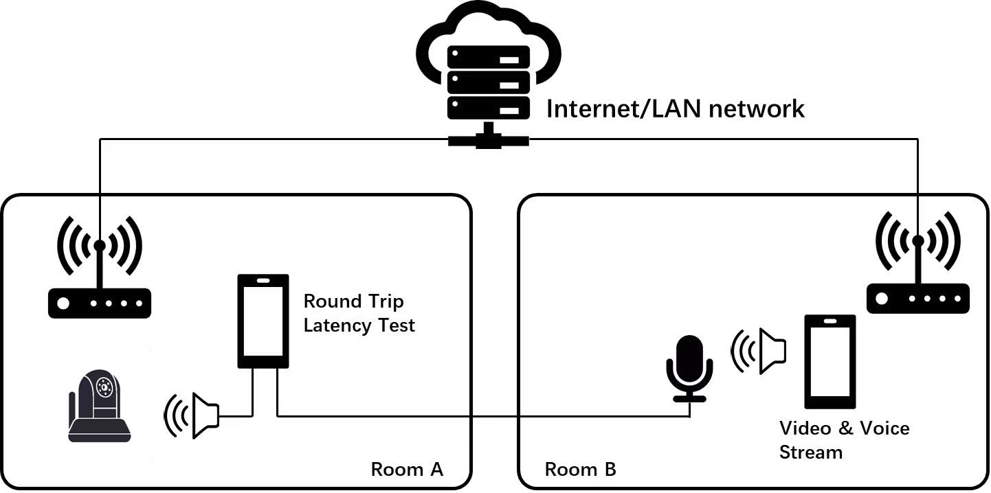

I plan to use the following diagram to measure the latency of live video streaming from a smart camera? Can it be done with your system? Any recommendation?

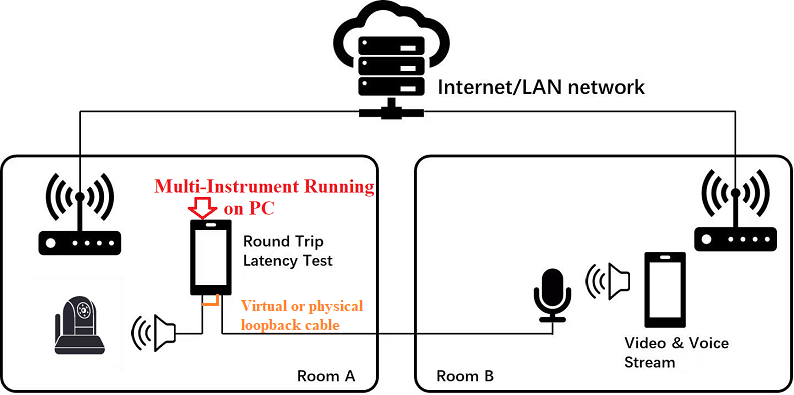

Sure. You can use Multi-Instrument together with a sound card with at least two input channels and one output channel to do it, as shown in the diagram below.
The test signal output to the speaker should be looped back to one input channel as the time reference. The other input channel should be connected to a mic to capture the live sound streamed from the network.
Cross Correlation function of Multi-Instrument can be used to measure the time difference between the two input channels, if the test signal is a wide band signal such as white noise and MLS.
Generalized Cross Correlation function of Multi-Instrument can be used instead for test signals that are not that "white", such as music and speech.

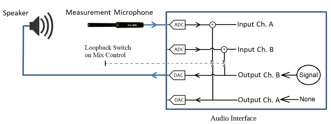

The loopback cable can be physical or virtual. Some sound cards feature a built-in software loopback switch. Once turned on, the output stream will join in the input stream linearly, and the final input will the sum of both. As both output channels will be looped back, the output signal looped back to the mic input should be set to 0 to effectively disconnect this route of loopback, leaving only the other pair of input and output channels connected as a loopback (see figure below). In this regard, VT RTA-268A/B (https://www.virtins.com/VT-RTA-268ABC.shtml) is recommended.

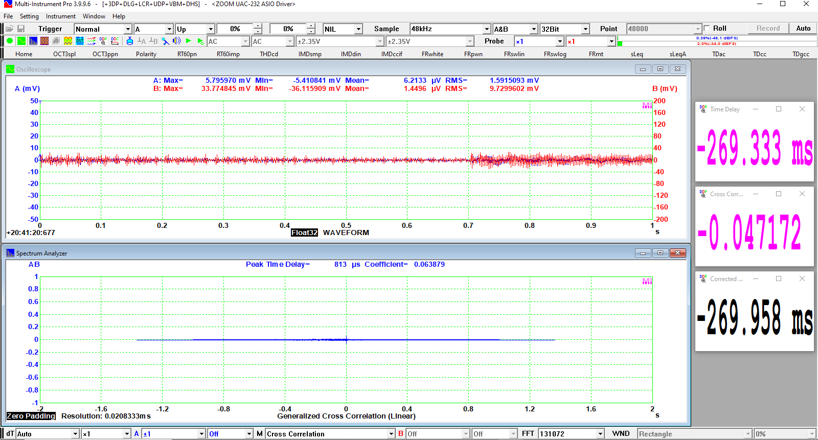

I have been using the TDgcc settings of RTA-268A for live video streaming latency monitoring. I tested many music and songs. It worked very well. However, I noticed that the software provided wrong measurements occasionally for some music, for instance, this slow piano solo at Youtube - https://www.youtube.com/watch?v=Rc63ZhEcCI4. In this test, I placed the mic only a few centimeters before the speaker where the music was being replayed. So the latency would be less than 1 ms. Then I used the TDgcc settings to monitor the latency continuously, sometimes the measured latency was correct, but sometimes it was not, I attach one picture here.

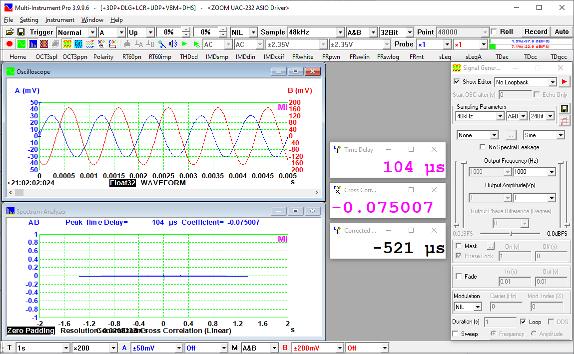

While Generalized Cross Correlation (GCC) doesn't necessitate a flat or white spectrum in the test signal for accurate time delay measurement, unlike standard Cross Correlation, it remains ineffective with periodic signals or those containing strong periodic components. For instance, when applied to two sine waves of identical frequency, GCC invariably produces a correlation peak within one signal period around t = 0 (see example below). Consequently, if the test signal possesses a prominent periodic component, this peak might overshadow the true peak, resulting in erroneous time delay measurement. Multi-Instrument boasts a unique and enhanced GCC algorithm, which enhances the robustness of time delay measurement, even in scenarios where the test signal exhibits some periodicity.

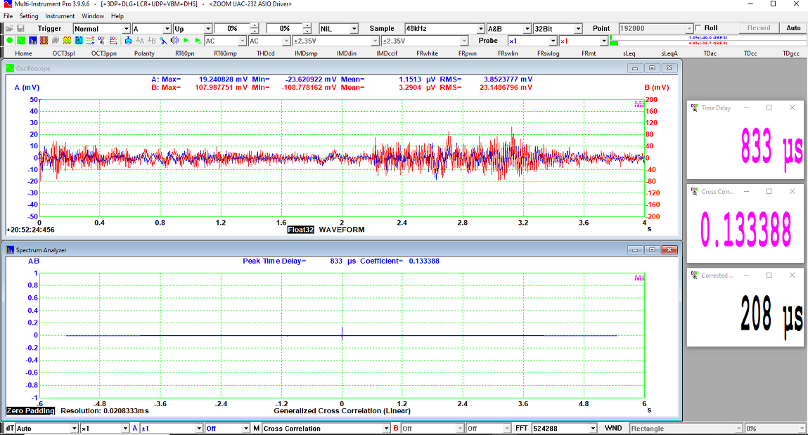

In contexts such as slow piano solos, where individual keystrokes are often spaced out, each keystroke generates a signal that is nearly periodic. The default record length of TDgcc is set to 1 second, occasionally capturing only a single keystroke for GCC analysis, thus leading to erroneous measurements. To mitigate this issue, consider extending the Record Length to capture multiple keystrokes in one Oscilloscope frame, effectively disrupting the periodicity of the signal. We changed the record length and FFT size of TDgcc to 4s and 524288 respectively. Then using the new settings, we continuously monitored the latency of the slow piano solo you mentioned. The measured latency was very stable without a single error throughout the entire duration of the music (see example below).
