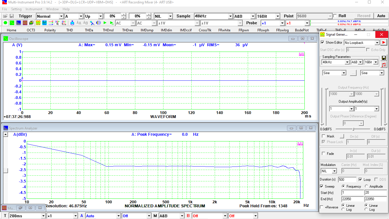

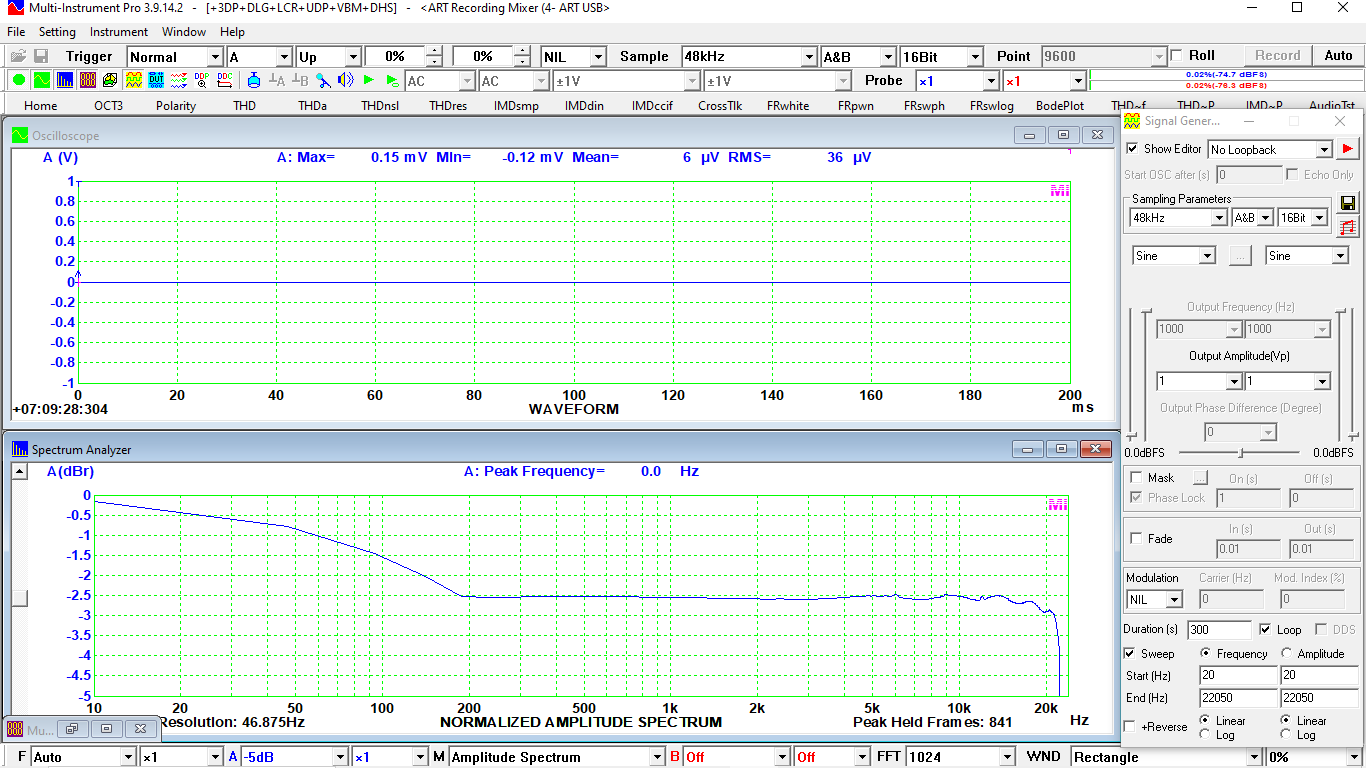

It seems I'm getting nowhere with this
This is a loopback FRswph of my soundcard with standard settings and applied Smoothing via Moving Average 5 points linear, soundcard should be +/-0.25dB within 20-20kHz range
Screenshot (479).png (82.45 KiB) Viewed 265847 times
This one is with a longer sweep 500sec
Screenshot (480).png (79.81 KiB) Viewed 265847 times
Could someone explain to me what am I doing wrong?

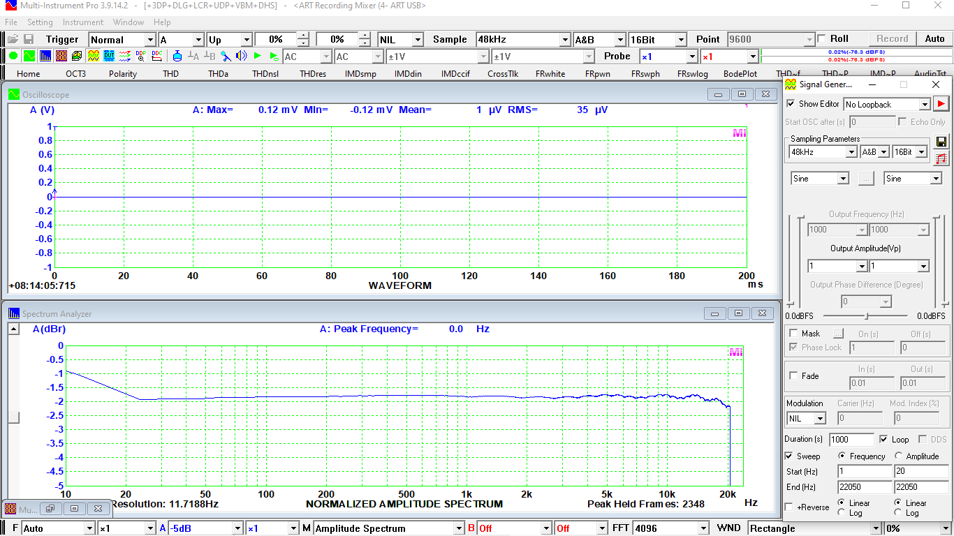

by Pete
Increasing resolution to 4096 and increasing sweep time to 1000sec with same Moving Average 5 points gives me this , looks better but still looks not exactly right
