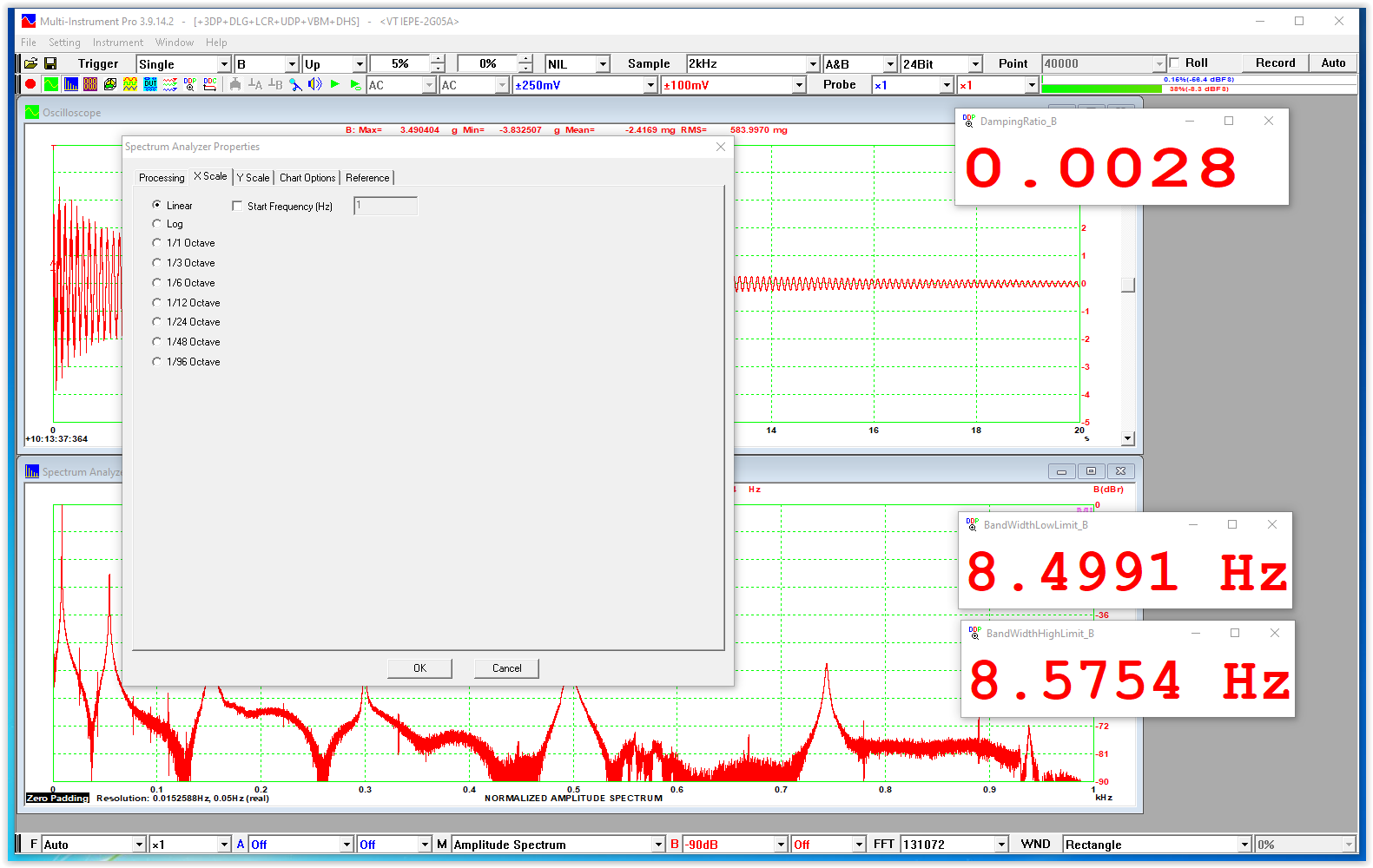

I encounter the following issue for bandwidth (-3 dB) measurement.
If the X Scale is set to Log initially, the DDP will not show the bandwidth information as shown in the picture below.
no bandwidth display
I have to use linear for X Scale to see the bandwidth data.
bandwidth available
bandwidth available
Is it a bug or not?
Thank you.

Thank you very much for the bug report. We will fix it in the next software release.
Posts: 316
Re: bandwidth measurement
This issue has been fixed in the latest version MI3.9.15.0
