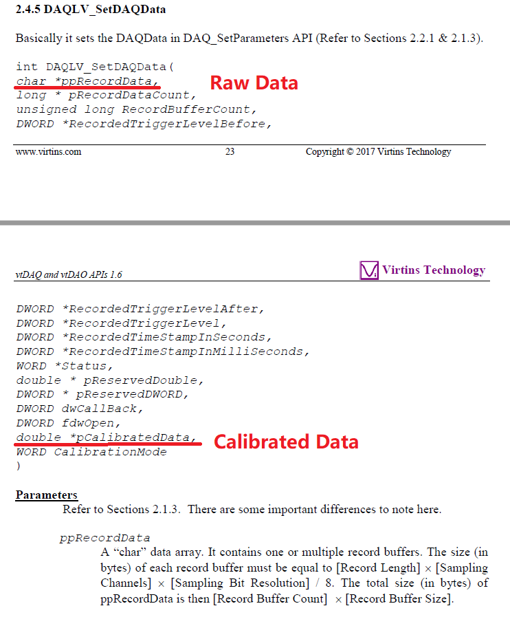

For LabVIEW development, vtDAQLV.dll and vtDAOLV.dll should be used. These DLLs can be found in the software's installation directory\DAQDAOAPIs\TestDAQLabViewAndCVI.zip and TestDAOLabViewAndCVI.zip respectively. The sample codes and API document can also be found there.
The pointer to raw data array and the pointer to calibrated data array can be passed to vtDAQLV.dll through DAQLV_SetDAQData API (see figure below, refer also to Section 2.4.5 of the vtDAQ and vtDAO API document).
If the calibrated data are not needed, let CalibrationMode=0 and pCalibratedData=NULL.
